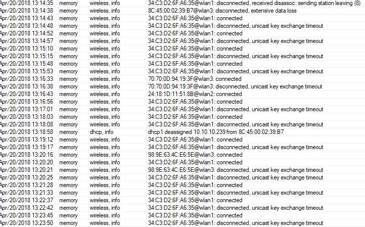

Attached a screenshot of how it loogs in the logs, observe the consistent triest to connect and the device just won’t accept the connection.
It worked for about 2 hours then it starts doing this.
