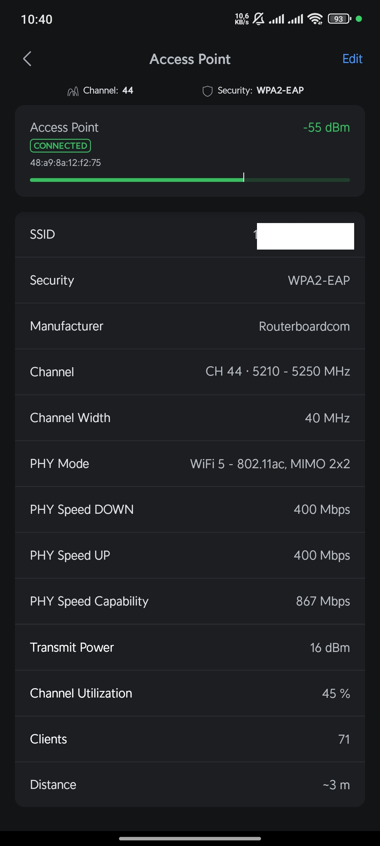

PROBLEM:
  • It appears when we get 40-70 clients on one AP, the WiFi speeds drop dramatically compared to other roomms with less than 20 clients. Sometimes drop to 0.
    This has been hard to troubleshoot becuase we look at the AP remotely and the CCQ looks good and the sppeds in teh registration table looks good, but the actual experince for the user is terrible.
  • The same devices elswhere on teh campus, with the saem configuration, are performing great. Only difference seems to be the client load.
  • Clients are 85%-90% on 5Ghz, but a few are on 2.4Ghz.
  • Most often happens when the entire class is doning online testing - so everyone is activly getting content.
  • Once the client load drops, speeds are good again.
Question: Is there a “known” issue with capAC getting overloaded with 40+ clients all downloading? Does anyone think a capAX will perform any differntly/better?

Well known problem for me, so here is a few tips and questions to better understand whats going on:
  1. Tell more about deployment, physical AP deployment - are APs deployed in classrooms? To have a good modulations you need APs in every room where WiFi will be used - classrooms, administration, event halls, cafeteria, sports hall etc. Also what I call secondary priority locations (locations that can have lower quality service - less amount/more spaced APs, providing lower signal and capacity than first priority locations, but still acceptable performance) like hallways, resting spots, outside of buildings, even small, dark corridors if people gather there and stay for longer that 5seconds (hyperbole, but not far off). I hi density networks it is very important to use airtime as effectively as possible (to get the most throughput and responsiveness) and split load by deploying enough APs. Secondary priority locations might sound like a resource waste, but reality is, if a station is connected to SSID it will always try to connect to it. In school example it means every device that is in hallway (even if just passing by) will try to connect to AP in classroom, creating two problems: a) That station will have low modulations comparing to stations in classroom, that will waste airtime. b) its additional load to classroom AP. Not a fun to have problem like this while students are trying to pass online exam. Besides, its nice to have proper WiFi access all over school for everyone.
  2. TX power only 6dbm is too low. School where I used to work had 8x6m classrooms, to get and hold 256qam modulations under load I had to set TX power to 16dbm. Of course, raising power rases issues about channels - are they not overlapping? Have to admit, it was hard to set channels on 75 APs. Barely make it and secondary APs did shared channel’s (no other way). TX power and channel overlap is one of WiFis balancing acts - you have to make balanced decision or prioritize on off. To be clean, I do not use auto channel select on networks like this, its too unpredictable. Also DFS channels must be used. My goal was a clean, non-overlapping 40mhz wide 5ghz channel per first priority location whit modulations mostly (around 2/3) in 256qam.
  3. What are actual throughput requirements? One of important planning stage questions. ac lineup whit ww2 (vendor) driver can push around 140mbps under load in classroom. Here in Latvia we have up to 34 student classes + teacher and support assistant, so 36*2=72 as potential ilde device count per room.
  4. You need to use ww2 drivers in hi dense networks, legacy/in house drivers have too may issues. See my topic about it: http://forum.mikrotik.com/t/my-experience-and-issues-in-hi-density-networks-at-school/164018/1
  5. ax is a better generation that benefits mostly in hi dense networks. I have no idea how and what you configured and deployed before, RUs alone will help in classroom scenario. But I currently cant recommend ax lineup as there is issues whit wlan driver. MT should get new ax driver from Qualcomm soon as issue is confirmed.
  6. WiFi is not easy and environment in wild. So I do recommend proper planning, deployment and monitoring after. It does not help if you arrive at evening in empty school. To see actual performance you need to test it under heavy/realistic load - while students are present and using their Chromebooks or tablets. Remote monitoring is important, but there things you can only see on location in action. When deployment is done, second phase is traffic shaping (vlans,bcast/mcast limiting, queues etc) to further improve network’s performance and security.

AP in every classroom is the only option now a days. Even if you can somewhat manage passable performance today - tomorrow demand will only increase. Remember what I said about two important things in hi dense networks - use airtime as effectively as possible and split load.
As I sad, 2.4ghz will be challenging, I ended up with TX power 6dbm (typically) and radio turned on in every second AP in that school. Those results I get while monitoring network - capsman registry table and some field tests. Result is somewhat usable modulations to stations that do connect to this band (around 20-30 stations total, half is interactive boards android module that is not used). But overall, in middle of the day 2.4ghz band gets so crowded, that those medium modulations are the least problem. Bluetooth devices, student individual hot spots and God knows what else just destroys that band, it means 30-70% channel load whit no actual traffic passed from schools network.
We also are port, airport and navy presence city, but we have to use DFS channels. Otherwise there is only x4 20mhz wide channels to use (U-NII-1) - its barely better than 2.4ghz band. You just have to deal whit it, also do think about it while planning AP deployment and do configuration, so you have passable network performance even when DFS event happens. Note, ac lineup is more sensitive to DFS events, so you will see at least a few APs going DFS every day. (I did report this to MT support. At home I have ax lineup APs and did setup ac lineup (cap ac and hap ac2) as a test for comparison. ax lineup on DFS channels have been triggered 4 times in 2024 (both, total in that year), the same channels now on ac lineup - hap ac2 a few events per day, cap ac less, but still relatively hi number)
If you are not using please do use frequency usage and scan features in ROS, as its the only way to make sure channels are not overlapping. This allows you to see what AP “see”. Goal usually is a clean channel for every AP in 5ghz band.
Complete AP halt is house/legacy driver known issue, so do use ww2/vendor drivers (those are drivers on APs). Read that post I mentioned before and do check help page - https://help.mikrotik.com/docs/spaces/ROS/pages/224559120/WiFi . Setup will require time and you will need to migrate to new capsman - but its worth it. It will feel like getting new APs, networks stability and performance will be noticeable immediately (assuming configuration is good).
