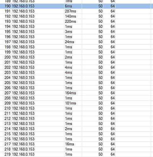

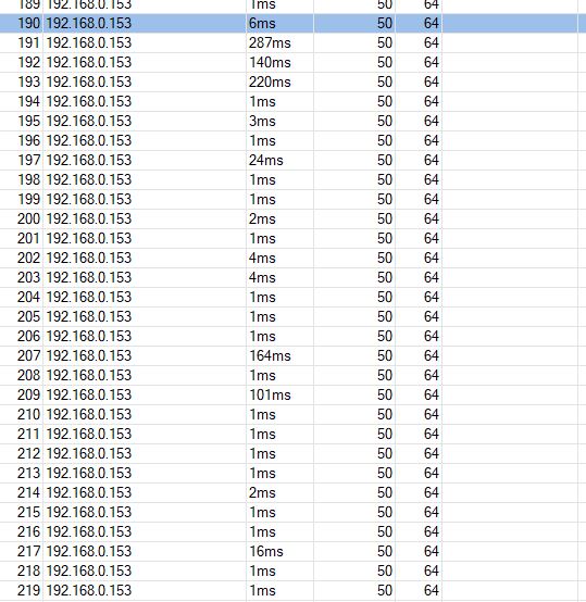

I just did a ping with the winbox to the prime stick while watching it has ping spikes (see screenshot)
I did as well a ping speed and the speed it jumping up and down from 17.6 Mbps to 273.1 Mbps back and forth.

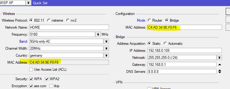

/edit while writing this comment which took a couple of minutes I am now able to connect to one of the CAPs
I am using it in the Home AP Dual mode. I will try the wisp mode now and remove DHCP from the CAP
/edit 2 is it normal that there are two differen MAC addresses ?
Mac addresses are normal.
One for wireless ITF (there should be 2) , one for bridge.
edit: NM
