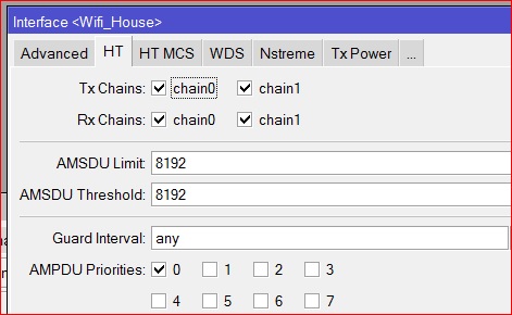

One of my capacs, Check out on the wifi tab advanced mode (HT) tab!

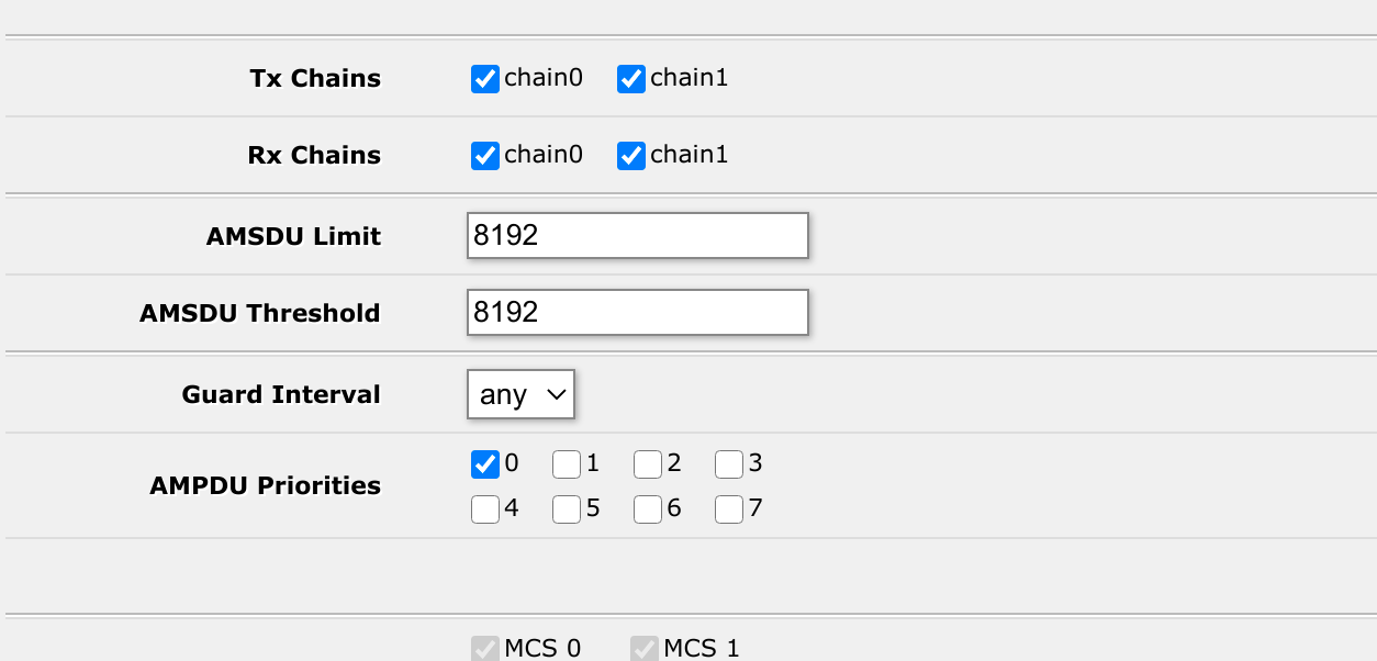

I had the expectation that the cAP would give 2 chains with 802.11ac, yielding a PHY of 866Mbps and throughput of 500, but I can get only 1 chain DOWNLOAD, and upload gets 2. In other words, I get 250Mbps download and 500Mbps upload using a known good 802.11ac client that supports 160MHz DFS 2x2 APs, which the cAP is a far cry from. My dinosaur “draft-ac” router way back from 2013 has 2 chains BOTH on download and upload and gets close to 500 with BOTH download and upload, so this shouldn’t happen.

Generally you don’t need to set any TX or RX chains in capsman. The default device values will use both chains for TX and RX. I see that it looks like you have modified the cap interfaces (changing the RX and TX chains). The 5G one is missing the RX chain config.
