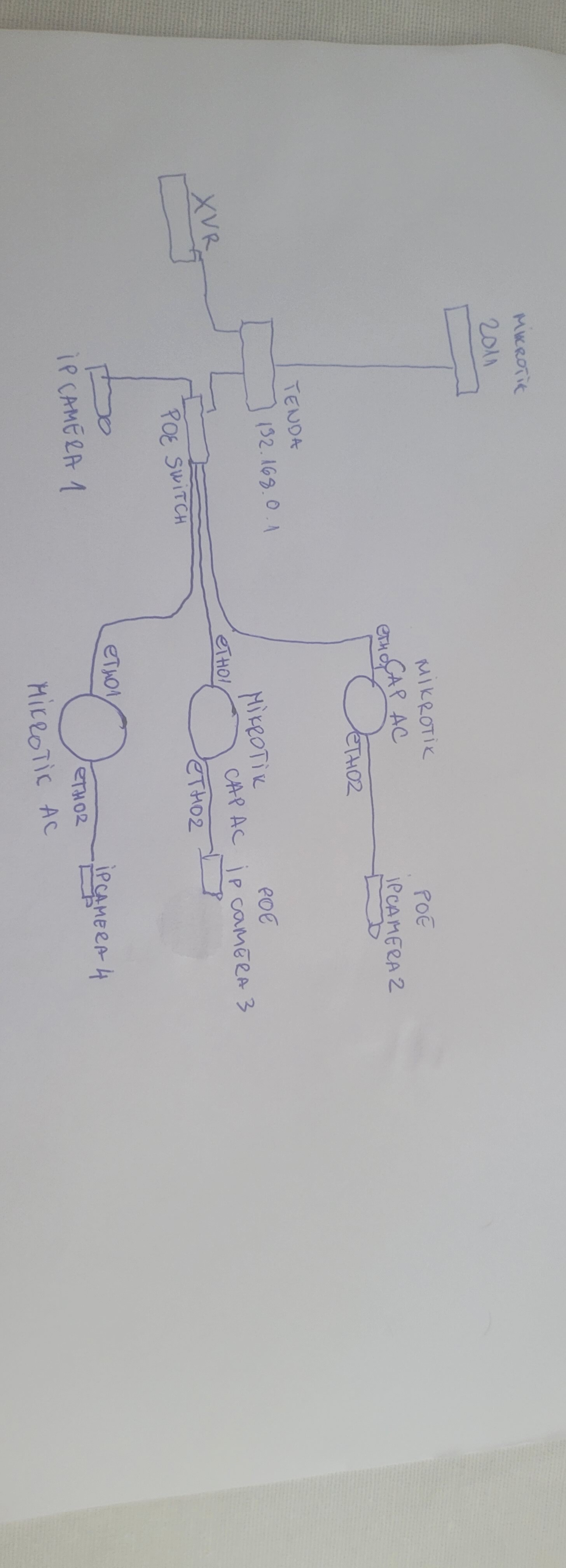

The cAP is configured as a fully standalone router, with firewall on the first port, then there is NAT, a public/private network and so on. You would have to reconfigure it according to your network layout. Can you make a small sketch drawing, how all is connected?
Here is a fast sketch.
So i want the Tenda to be able to see the ip cameras connected on the eth2 of the CAp Ac and at the same time be AP.

I guess cAP ac devices could be configured as simple ethernet switch / AP combo, i.e. both attached IP cameras and wireless clients become part of common LAN segment, fully governed by main router (RB2011).

So in more detail, bridging eth01, eth02 wlan01 and wlan02 all together, set DHCP and clean the firewall should do the job?

No, it’s not WISP. AFAIK WISP mode uses one of wlan interfaces as WAN interface (instead of ether1), sets firewall almost as standard except for management access which is allowed from WAN and not from LAN (other modes set it just the opposite).
As I wrote, I don’t think there’s QuickSet mode appropriate for that kind of use. The easiest way of configuring device into “switch + AP” mode is to reset with no configuration and use winbox (MAC connection) to configure things as outlined in my previous post.
