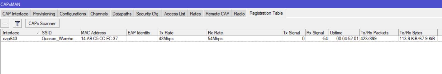

Thanks to those that have provided suggestions on this ongoing CapsMan & wireless config issue. I tried using CapsMan to automatically reselect the frequency on each of the 29 cAP-ac units in this 360,000 sq ft warehouse, but I found that too many of the APs were using the same 5ghz frequency. Because of this I have abandoned CapsMan for now and have gone with configuring each cAP-ac unit individually. Currently each AP has the same SSID, and encryption code, but the frequency is assigned in an alternating arrangement to keep the APs that use the same frequency physically separated - ie neighboring APs use different non-overlapping 20mhz assignments. With this configuration, ping times to the local gateway IP are better than before, but still not great. Here are the typical results we are seeing:
Ping statistics for 10.255.1.2:
Packets: Sent = 100, Received = 96, Lost = 4 (4% loss),
Approximate round trip times in milli-seconds:
Minimum = 1ms, Maximum = 123ms, Average = 26ms

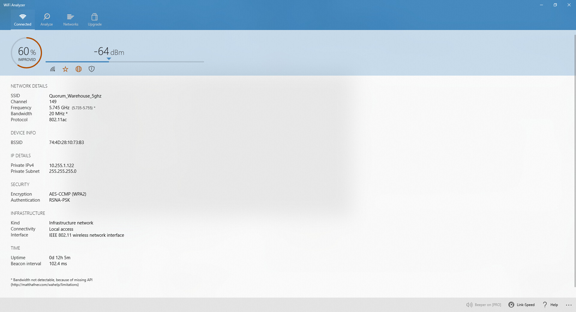

Here is the connection info from the test laptop:
Here is a graph if what the wifi analyzer sees:
We are also experiencing wireless devices constantly hopping from AP to AP. To combat this, I have added an access list rule that restricts access to clients with a -65 signal or better, like this:
/interface wireless access-list
add comment=“Restrict wifi connections to -65 or stronger” signal-range=-65..120
Sadly the rule above has not fixed the problem. I have also tried to manually decrease the TX power on the radios in the cAP-ac units, but when I do, I get an error that the feature is not supported. Any suggestions as to what I can do to stabilize the ping times and keep the wireless devices from hopping from AP to AP, even when located in one spot?
