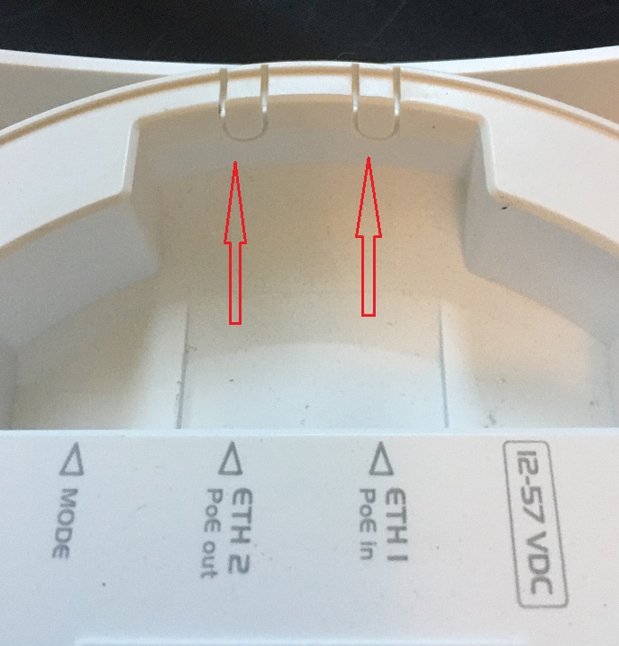

So I’m interested in buying a few cAP Ac units.
I want to walk mount them all but the cable need to run along the wall and all info I can find or pictures shows the cable exiting out of the wall.
So simple question is possible without modding the unit to wall mount them with the cable running down the wall (with the stuff you get in the box)?
To have the cable run out the side of the cap ac, there are two molded u shaped sections next to the Ethernet connections that can be removed (gently with needle nosed pliers).
I don’t know if that counts to you as being modded, but that is what they are for.
Cool biomesh, I hadnt noticed that before!!
Many thanks, you guys are awesome. This picture should be added to the documentation of the unit :slight_smile:
