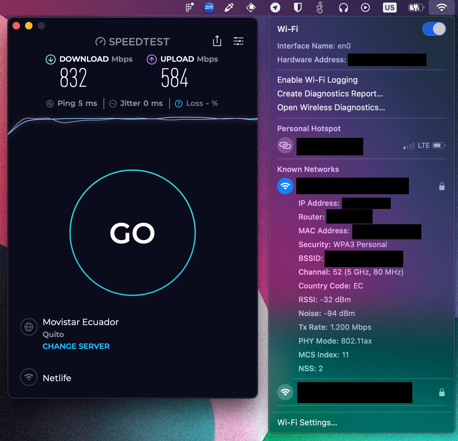

I don’t think so. To achieve a throughput of ≥ 1 Gbps over WiFi, you typically need a 160 MHz bandwidth because WiFi generally operates at about 60-70% efficiency of the PHY rate. At my home office, I have an 850 Mbps internet connection, but my hAP ax3 cannot fully saturate the connection with a single 5 GHz WiFi client (my MacBook Pro).
PS: the AP is over my desk :stuck_out_tongue:
