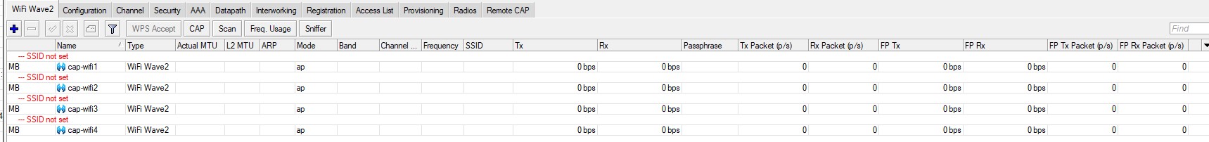

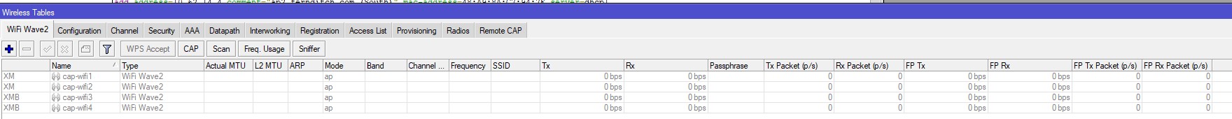

The only thing I see on the CCR2004 is grayed out wifi interfaces:
The radios show up, and the remote CAPS, so there’s at least connectivity, but simply no SSID being broadcast.
…and if I just manually enable those interfaces, I get “SSID not set” (and still no broadcast of the network)

And the radios provision, but just never enable the interfaces:
I just see nothing wrong… any ideas?

“SSID not set” was in our case the delete of an SSID. Under Provisioning the system is not deleting the slave config (replaced by something other)… Delete the wrong slave removed the “SSID not set”.
