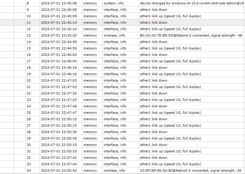

Ah… just noticed this (log from the CAP – interestingly it’s not showing in my syslog, it must dump the “down” syslog message because ethernet is down, and not buffer it). The switch shows nothing in its log.
I think this CAP is just defective. I guess I need to figure out how to get warranty. It’s like 3 days past the Amazon return period. :frowning:
Unless anyone has better ideas.
I realized I was not sure after the rewire if I was on the same port, so I switch ports to another one. This time I could not even connect. It would draw power, bring the port up (hard coded to 1g/full) but couldn’t ping it at all, then the port went down.
So… dead. Or a reasonable facsimile.
