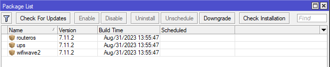

I have start the cAP ax normal and install the latest OS: 7.11.2

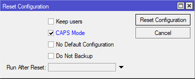

In a second step i reset the cAP ax to CAPS Mode

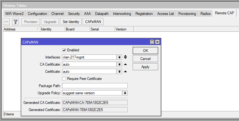

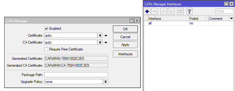

The CAPsMAN is configured to all interfaces

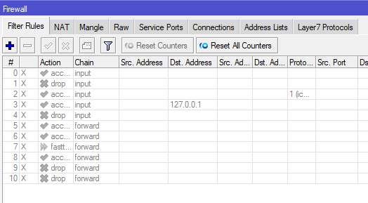

And the Firewall is turend off for truble shooting:

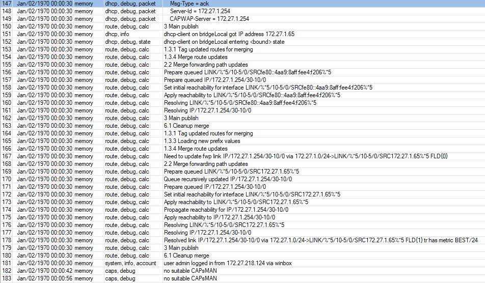

At this point we may be more interested in the caps config …
Because that log shows it can not find capsman.
And time/date stay horribly wrong as well.
Definitely not correct.
So my first look would be to that device.
This is what a normal log file looks for a cap AX in caps mode after reboot.
(obviously I don’t have debug on …)

You are running the “old” CAPsMAN while the cAP ax only supports the wifiwave2 CAPsMAN. No backward compatibility, will never come (I think I red that).
You will need to install wifiwave2 on the RB5009 and configure it from there:
https://help.mikrotik.com/docs/display/ROS/WifiWave2#WifiWave2-WifiWave2CAPsMAN

Thanks for this Information now i am on WiFi Wave2 and CAPsMAN :slight_smile:
Now i have also installed the wifiwave2.npk on the Router :slight_smile:
Thanks for the Information, after install the wifiwave2, it get a connection and config.
