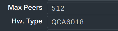

from an ax3:
Each Radio has 512 Peers Limit but that's not really realistic.

The cap ax can sustain 1024 clients (512 per interface)
