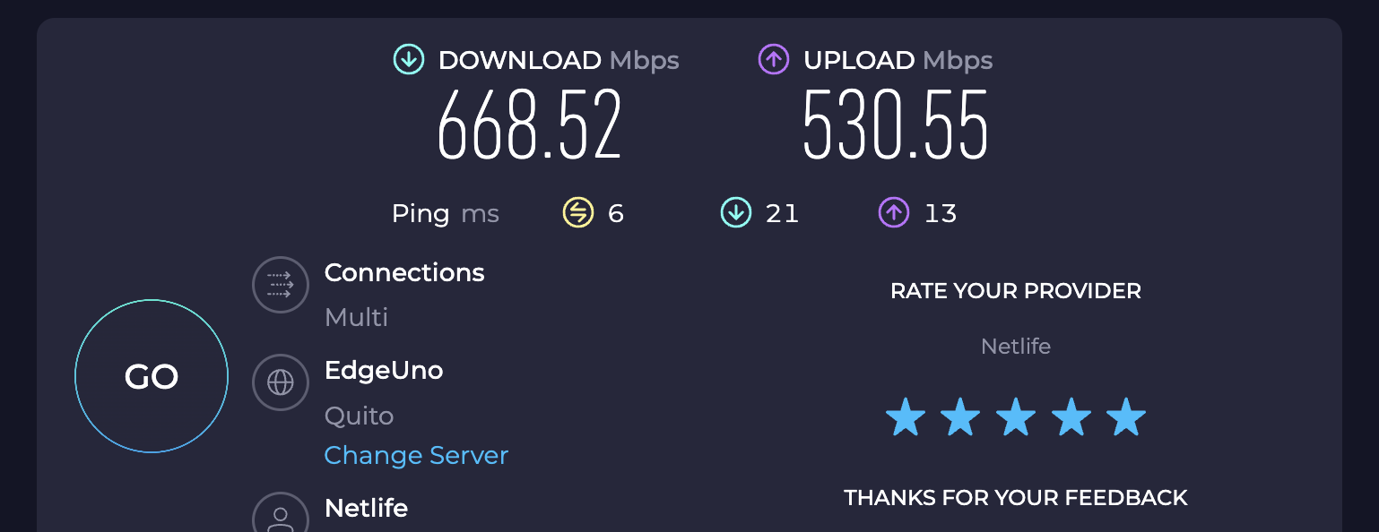

This is what I get from the AX3, my WAN speeds are 670/670mbps

Wall mounted cAP AX running 7.17beta2, didn’t bother getting of the couch to get any closer to the accesspoint(which will improve speed).
Configured very basic with CAPsMAN. As client I’m using the Intel(R) Wi-Fi 6 AX200 using driver version 23.70.2.3.
When testing using internal iperf server, I frequently see 700-ish on AX devices.
Mikrotik hAP AC2 to CRS328-24P+4S-RM on to XV2-21x.
