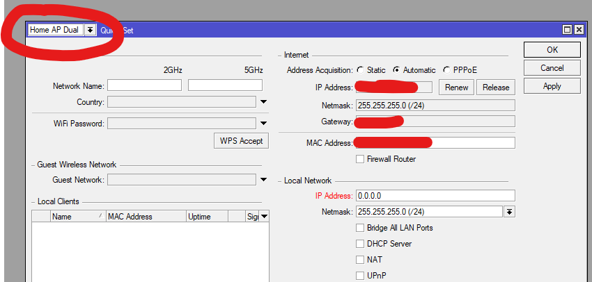

I have many RB962UiGS-5HacT2HnT and other older CAPs, where I can simply set the CAP in the winbox ( Quick Set, left top corner ) or reset the device during boot ( 10 seconds ), but in CAP AX none of those options works - in the Quick Set I have only Home AP Dual mode to choose and even reset is not changing configuration to CAP. Any idea what`s wrong? I have updated it to the latest version, it didn’t help at all. According to the documentation CAP AX should be working with CAPsMAN, but… it doesn’t in this way.

I have previously activated CAP in the GUI but I couldn’t change in the quick settings mode to CAP and it was still “Home AP Dual”.
I will have a look at CLI in the free time and will try to see if there is an option to change Home AP Dual to CAP, as still… with Home AP Dual
mode I have problems configuring the rest settings.

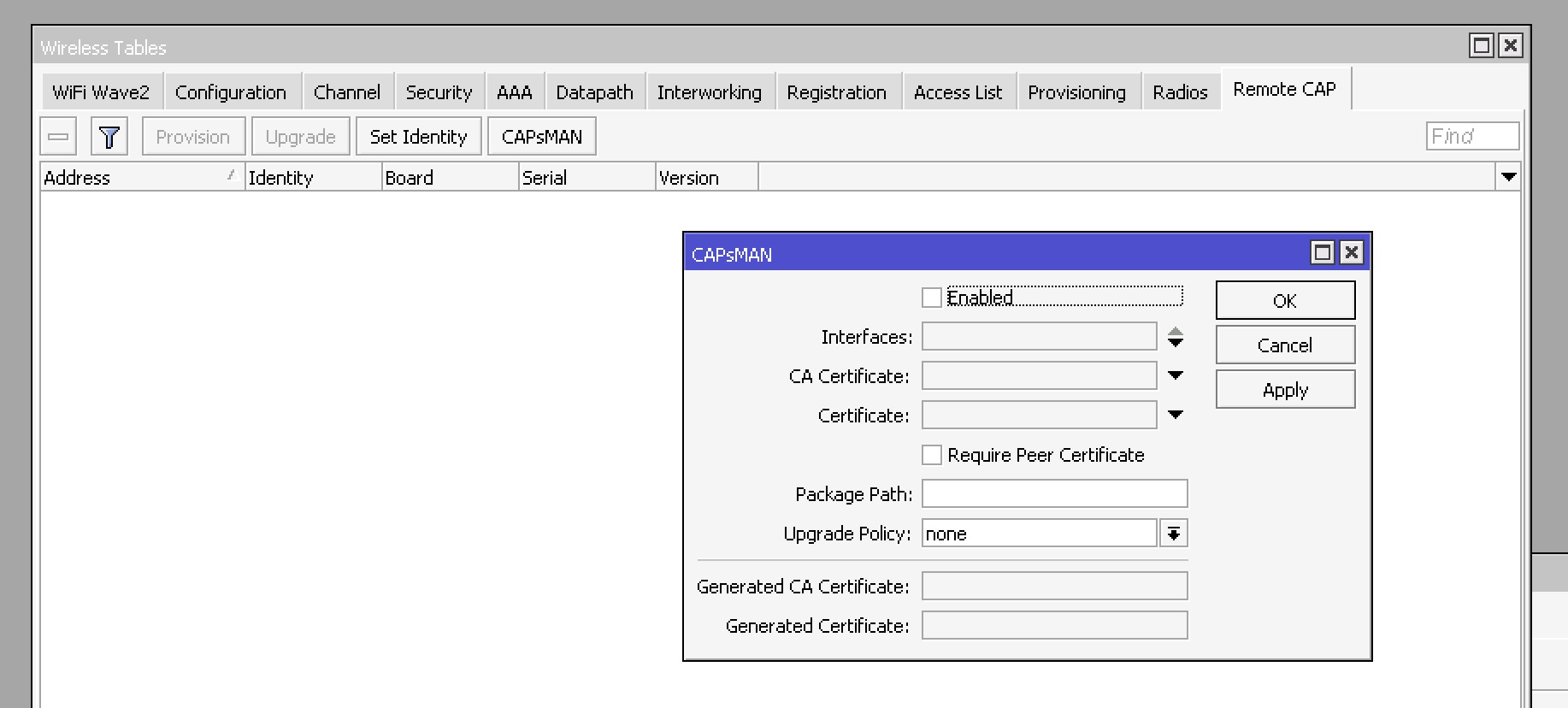

CAPsMAN ir available in Winbox too
Yes, thats correct, but... I have already CAPsMAN - its my main router CCR2116-12G-4S+
I just want to add CAP AX as another CAP to my network, but cannot change it to CAP in quick set.
CAP is enabled,
Having it as Home AP Dual creates issue as… it connects to my main router but it wants to be a router as well by creating new local network, which is not what I expect from it.
In Wireless Table I have error: no connection to CAPsMAN, even that CAP is enabled.

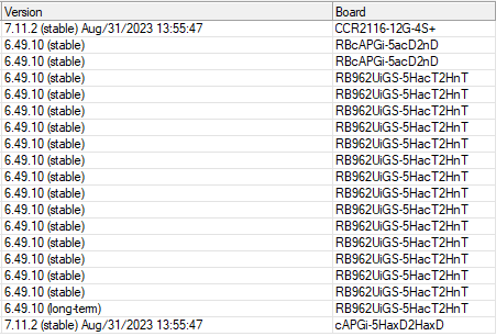

That is confusing now… I thought that there may be an issue between v7 and v6 but… at this moment I have main router with v7 and had all CAPs with v6 and it worked very well, but now I can see that in my CAPs v6 there is “WiFI interface” and in cAP ax “WiFi Wave2”
So… Simply, do you want to say that if I want to connect cAP ax to my existing network I have to remove all v6 CAPs?
That`s the list of my devices in one of the locations:
CCR is the main router with CAPsMAN enabled, where the rest are CAPs - the last one is the cAP ax that is not willing to cooperate.
OK, will try now. Thank you.
So there is CAPsMAN that works with legacy WiFi drivers and then there is CAPsMAN that works with new wifiwave2 drivers that are in all new ax devices. There is no way of installing legacy drivers to ax devices nor legacy capsman can work with new one and vice versa.
Your current CAPs don’t support wifiwave2 so either you have to replace them with cAP ax or something else in ax lineup and install wifiwave2 package on your CCR so you can configure wifiwave2 capsman or configure cAP ax to work standalone device.
Cool, that solved the first problem - instead of Home AP Dual I have now Ethernet mode, where I can choose Bridge mode instead of router.
