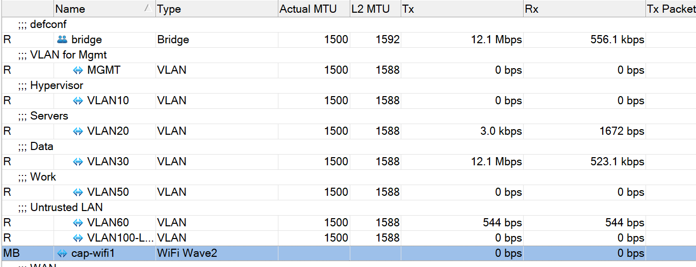

Cap ax: cAPGi-5HaxD2HaxD connected on ether10 which has VLANs tagged.
3 SSID on two VLANS (will add a 3rd, but want to get clients connecting with IPs from their respective DHCPs)
All existing VLANS are working correctly elsewhere, but it seems I’m missing something rather simple most likely.

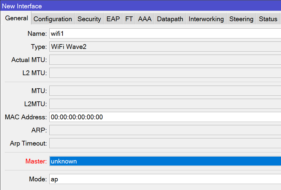

I may not be looking for the correct thing in the log, but if I’m searching for the radio MAC, I’m not getting much information showing me why I am not connecting.
I believe I have the AP in CAP mode correctly. Odd thing is since I upgraded the AP, I can’t reset the device to factory default anymore. I’m not sure that I need to at the moment, but why I cannot is unclear to me. Same method worked at least 5 times prior to me discovering RoS software / package mismatch version issue. Upgraded and have everything on 7.12 and RB4011 now sees and adds the interface.
Grateful for any assistance and will provide further info if requested.

I enabled the interface:
On RB4011, Manually set the SSID, Channel, Security, Datapath bridge and VLAN 30 on the cap-wifi1 interface.
Client connects to the SSID, but does not get an IP.
Then,
Added cap-wifi1 to bridge, ingress filtering, admin only untagged and priority tagged, PVID 1. Same result.
Remove Datapath bridge and VLAN 30 from Interface setting. Same result.
MAC@cap-wifi1 connected, signal strength -49
So for CAP you should have your mgmt or any network that you have CAPsMAN running untagged and VLANs that you want to use on that CAP tagged. Does your CAP have connection with CAPsMAN controller ?
Change: RB4011-> ether 10->PVID from 1 to 99.
Effect: CAP now receives IP in mgmt VLAN 99.

Still back at square one. Device not detected on Router. Master: Unknown

Why did you enable CAP mode here ? You need to enable CAPsMAN, under Remote radio you have CAPsMAN option.
How did that MAC address get there?
