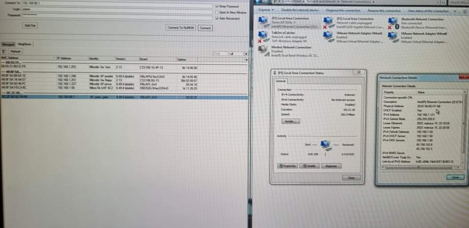

Guys, thank you for both! No it looks ok working well. I just connenct my laptop to “station-bridge” cap via ethernet and working well.
Only one thing, I cannot access this cap beacuse of the ip addr is the inital “192.168.88.1” and my pool in hap2 is working from 192.168.1.100… 192.168.1.250. So I’m not in the same network.
How can this station-bridge cap get a same local ip address? (192.168.1.xxx)
On the discovery page of winbox, click on “station bridge” cAP MAC address … after logging in, change IP address on bridge.
Thanks, but I don’t want fix ip (if not necessary…). Is it possible to get it from hap2?
Remove fixed IP and set DHCP client.
Also remove DHCP server so all clients connecting to that device will get it from hap.
thanks! working well everything!!!
