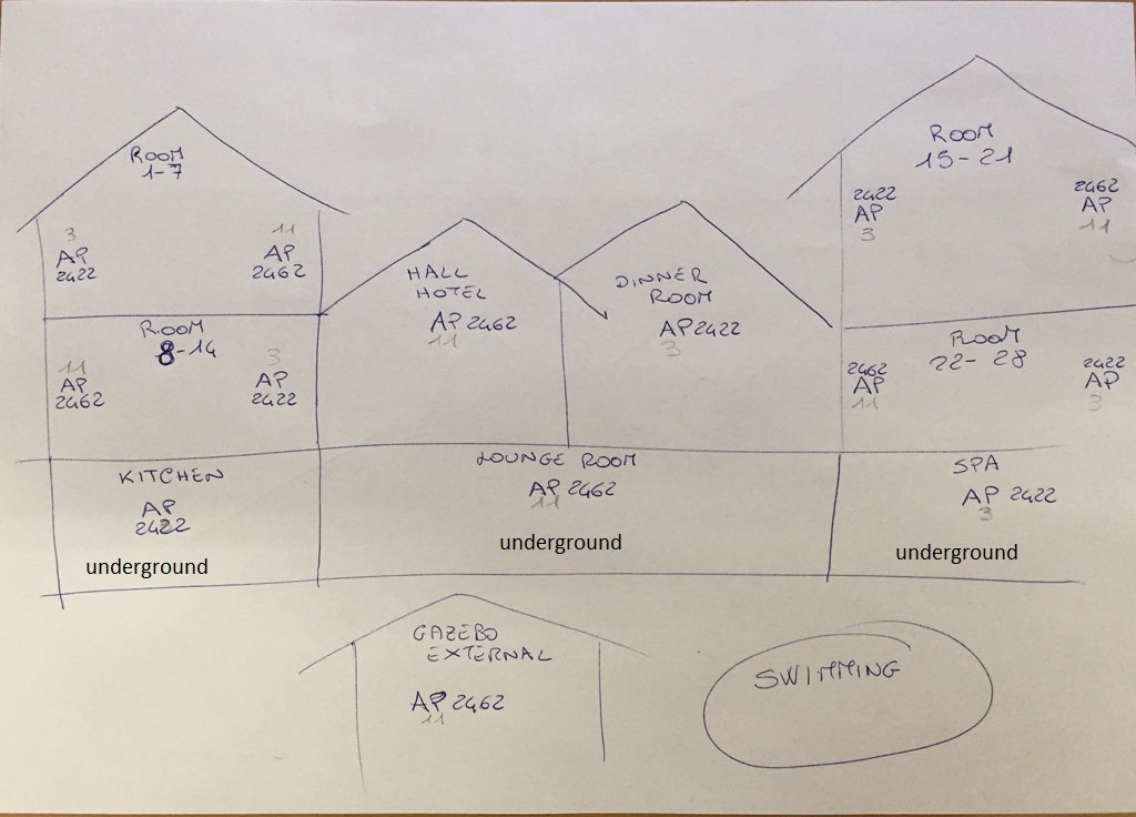

I’ve install 14 Access Point ( Mikrotik cAP Lite) in a Hotel.
All the access point is connected with lan in a switch and is in the same network, and all have the same SSID and WPA2-EAS.
I’ve planing the setting of the access point radio not disturb the one with the other, and use this setting:
AP1, (channel 2422):

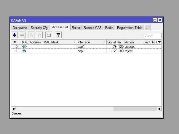

Hello friends for help me and replay.
I test the capsman in my house. I’ve a RB2011L to set the capsman and i connect it an cAP Lite for test.
The system is work very fine.
I’ve set the access list in caps-man ( Rb2011), It’s ok this setting rule?
In the Hotel, you can recommend me to use the same channel (example chanel 6) on all access points, or you recommend using two channels, for example chanel 3 for AP1, AP3, AP5, AP7, AP9, AP11, AP13 and chanel 11 for AP2, AP4, AP6, AP8, AP10, AP12, AP14 ???
What is the better solution for a correct planing?
Thaks very muth
stefano
  1. About signal range: as i had sad my example doesn’t “perfect”. It is just averaged level - in your particular situation signal level can be a little bit other (but i don’t think it will differ a lot)
  2. set “interface” to “all” or don’t forget to add all caps to it (in this case also make caps static)
  3. About channels: in some cases it will be batter to set different channels manually to caps (i didn’t test with 6.39.1 but on some older versions of ROS there where some problems with auto channel in capsman)

I planing this situation, and use two chanel ( 2422 and 2462) for all the device. What do you think?
I don’t now if is better use “auto” channel for all device, if 6.39.1 routerOS is supported and have no bug.
looks good.

In a hotel situation for 2.4GHz be sure to only use 20MHz channels, protocol=802.11, set distance=indoors, ht-guard-interval=long and only use channels 1,6 & 11 (2412,2437 and 2462).
The access rules you already know about.
Why to use 20 Mhz and why 1,6 and 11 channel? Can you please explain?
To minimise interference between neighbouring accesspoints.
In the 2.4GHz spectrum there are 11 channels each separated by 5MHz (13 or 14 in some countries)so with 20MHz Channel width there are only 3 channels that do not overlap. Channels 1,6 & 11 are the only ones you can use that allow AP’s to operate in the same space without interfering. Using 40MHz channel width only decreases the number of non-overlapping channels.
In a hospitality site we configure the 3 channels so that adjacent AP’s frequencies do not overlap, adjust the tx power so the coverage only just overlaps between AP’s and we use access lists to ensure clients with a weak signal are forced to find a better AP.
Capsman (6.40.x) now allows you to specify the three frequencies (2412. 2437 & 2462) in theconfiguration and the AP’s will workout which of the 3 channels is best to use. It can also remember the channel choice for faster startup from reboot, and you can specify how often they recheck to see if they are on the best channel.
