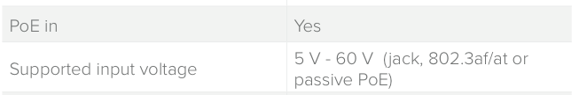

According to its specific brochure, dated 10th April 2017 (manual is dated on 30th Nov 2016)
It does support the three options: Passive, at and af.
Yes, it works with 802.3af/at
