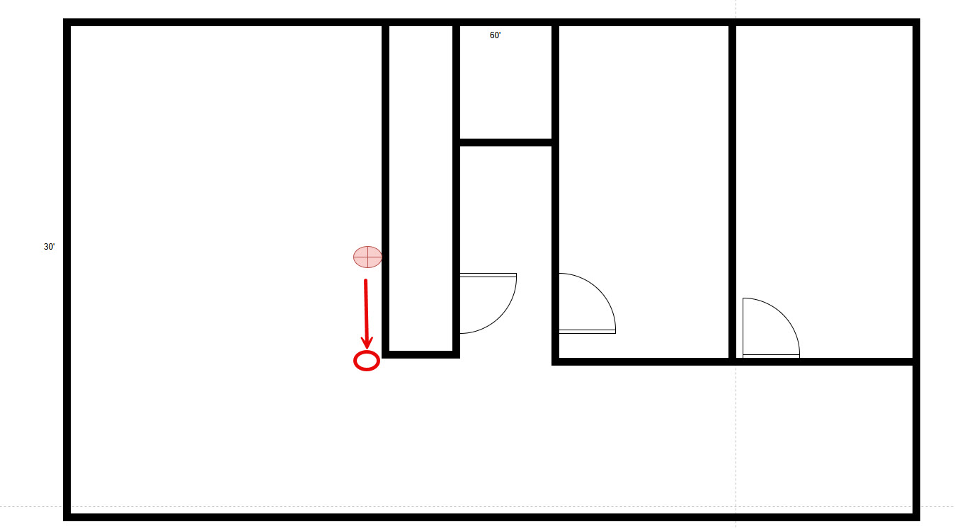

I have a floor in a house with multiple rooms in an apartment that needs wifi coverage.
Walls are concrete block (thick) – not very RF friendly.
All I need is AP capability (will sit behind RB5009) and will be generally centrally location and will be mounted against a wall (in pink on diagram).
Would I be better off with an ax3 or a cAP (wall mounted) or a different model?

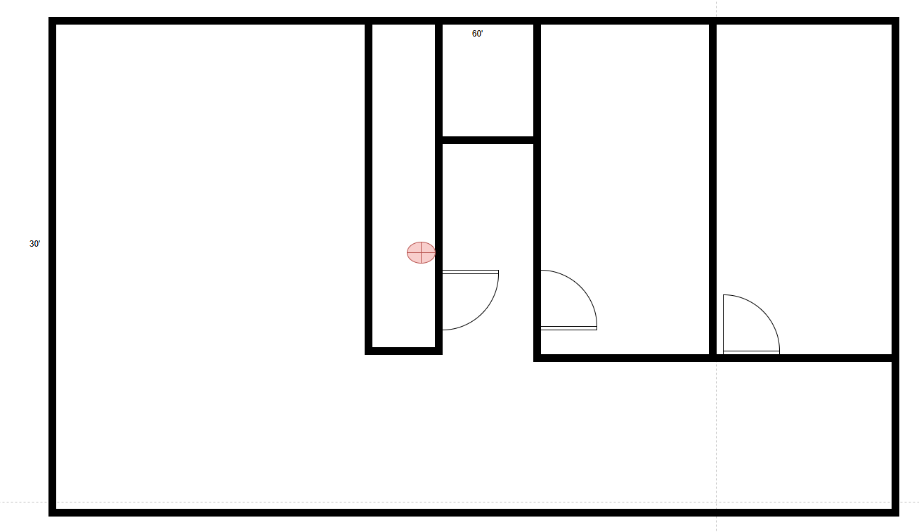

IF all your allowed is one device, then why place it right away inside four walls. If anything I suspect a ceiling mount would be better (guessing)
However, you should really have posted in the wifi forum as keen wifi folks hang out there …

The ceilings are off-limits. They building has 8" solid concrete floors/ceilings and it is a major violation of the building rules to even drill into them, let along channel cable.

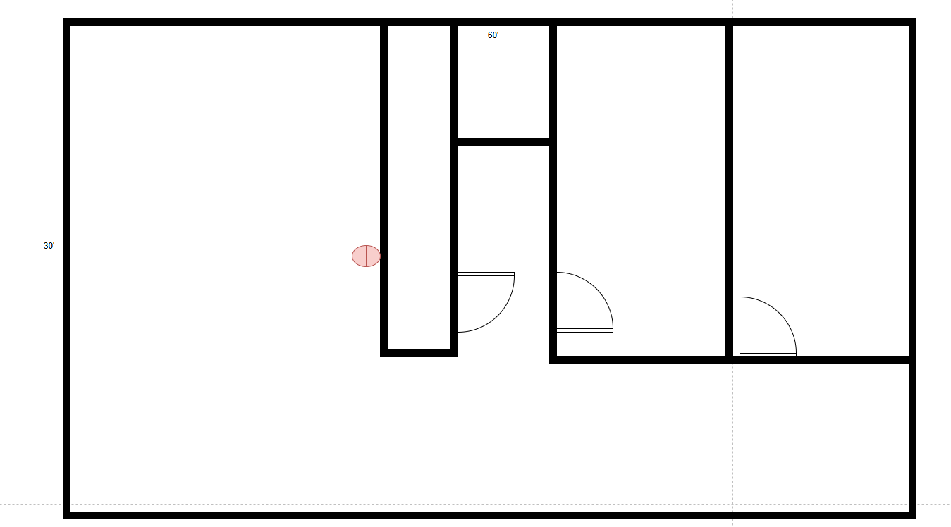

So, basically, I am stuck locating the AP inside the tech closet as shown, or wall mounted on the living room side of the shared wall, like shown below. And, wall mounting.

Why not use the corner then ?

I could do the corner, but I’d be surprised if it make much difference.
2 APs, let alone table mounted, would fail the WAF (wife acceptance factor) immediately. In fact, it is likely that the AP on the outside of the wall rather than inside (my first drawing) would fail WAF.
Testing would be best done by mounting in locations, which means screw holes in walls, which would not be fun.
The space is really not very large, and I really only need coverage for about 2/3 of the space.

Line of sight will be better for most of the area so it will make a difference.

Also take into account an AP mounted on the inside of the wall will be radiating largely towards the wrong area.
