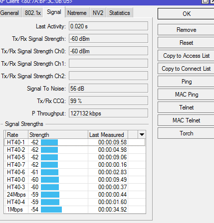

So we got one of this for an customer, but i cant get any good performanse out of it, in best case i can get around 30mbit on speedtest from this router, i tried reseting it to factory, upgrade latest software but nothing helps.In most occasions we get around 5-10mbit, doesnt matter if im near router or 10m away, in connection stats everything looks okay, but real life stats are very bad.
See pic from my HTC10 connected to it, i can get max 25mbit, and most cases barely10mbit, standing near router 3 meters (tried puting it further)
What could i be doing wrong?Or this unit is bad, or entire series is just bad?

Connection states 150mbit connection, and if you see my screneshot it shows around 120mbit throughout, i got many other 150mbit routers around here from various manufcaturers and when i connect them i can get up to 100mbit speeds without problem.

150 Mbit/s is the PHY-rate, not the TCP throughput. You are comparing two different things. Plus the 150 Mbit/s can only be achieved with 40 MHz channel width which is hardly usable with 2.4 GHz, so you’re down to 75 Mbit/s PHY-rate. Since wifi is half duplex you’ll only get around 40 to 45 Mbit/s TCP troughput.

So whats the actual deal?If what your saying is true, why is this router even showing 150mbit on my phone if it cant achieve barerly 30, and the routers i tried are pretty old ISP routers i got laying around, and definitely dont have 2x2 ..

As I said, you compare the PHY-rate to TCP throughput. Those are two different things. The 150 Mbit/s isn’t what you get with TCP. It’s just the Layer 2 data rate.

Maybe you’re right and the cAP should get you higher troughput, but based on my experience ~30 - 40 Mbit/s TCP seems reasonable with 20 MHz, a single chain and a clear channel, but not much more. It would really suprise me if you could get 100 Mbit/s TCP out of a single chain configuration with your Metal.
