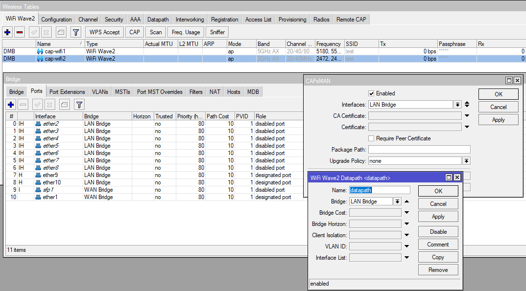

Hi guys,
I have an issue with internet connection on cap-wifi. My network configuration are following: mikrotik RB3011 (router) and cAP ax (CAPS mode). cAP is connected to the router via the eth10 port. Router is connected to the ISP modem via the eth1 port. WifiWave2 package is installed on the both devices.
Datapath is configured, but cap-wifi interfaces are not show up on the LAN bridge. As I think they should. Am I right?
troubleshooting:
  1. I connected laptop to the each eth2-10 on the router - internet connection worked.
  2. When my cAP ax was connected to the router (eth1 > eth10) I connected laptop to the eth2 port on the cAP ax device. Internet connection worked.
    3.I tried to turn off all firewall rules. No internet connection for wifi.
  3. I used default configuration on router and turned on CAPsMAN. No internet connection for wifi
  4. Wifi client is getting IP address and gateway from dhcp
  5. I added cap-wifi interfaces to the LAN bridge (on router) manually. No internet connection
cAP ax config (default, CAPS mode):

Can you help me fix the issue with wifi internet connection? I have no idea whats wrong in my config…

gateway cannot be on zero address x.x.x.0 (example 192.168.88.0). After I changed address for x.x.x.1 internet connection started to work.
Which firmware bug ?
Gateway can be on .0, only not in /24.
So user error ?
ROS allows a lot of things, even big mistakes.
