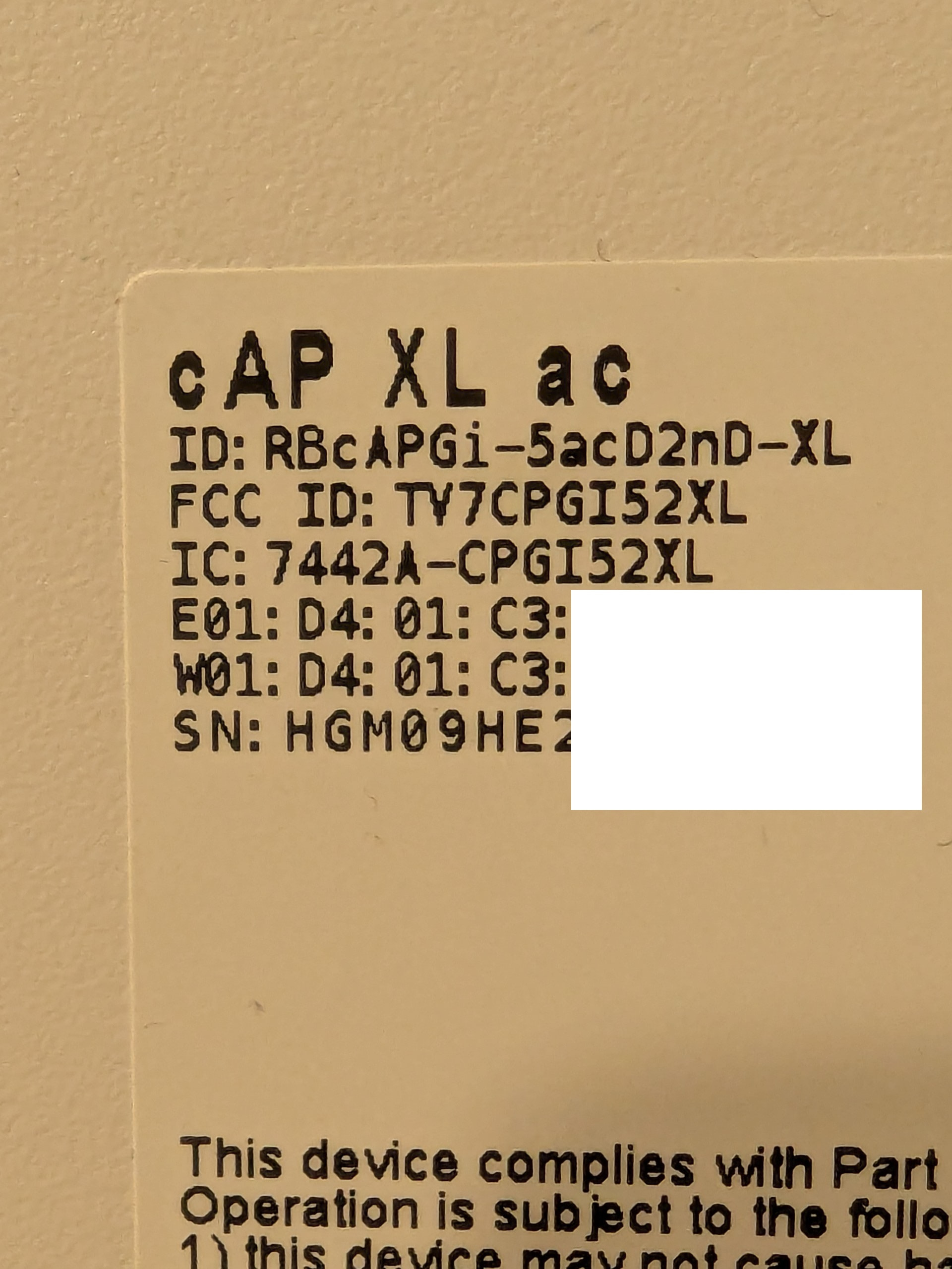

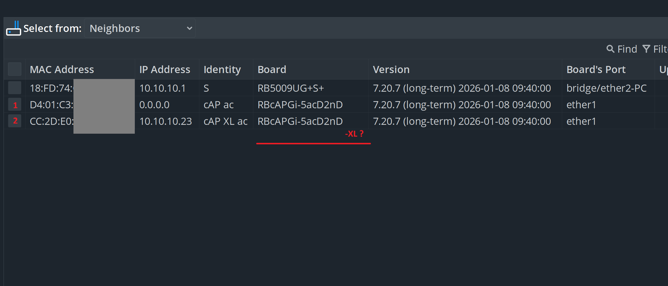

    The problem is that all 3 new cAP XL ac routers in RouterOS and Winbox are displayed as regular cAP ac without XL in the model name. Factory images of XL routers are version 3.43, which is strange.
Look at the screenshots for comparison (MAC addresses and serial numbers are hidden).

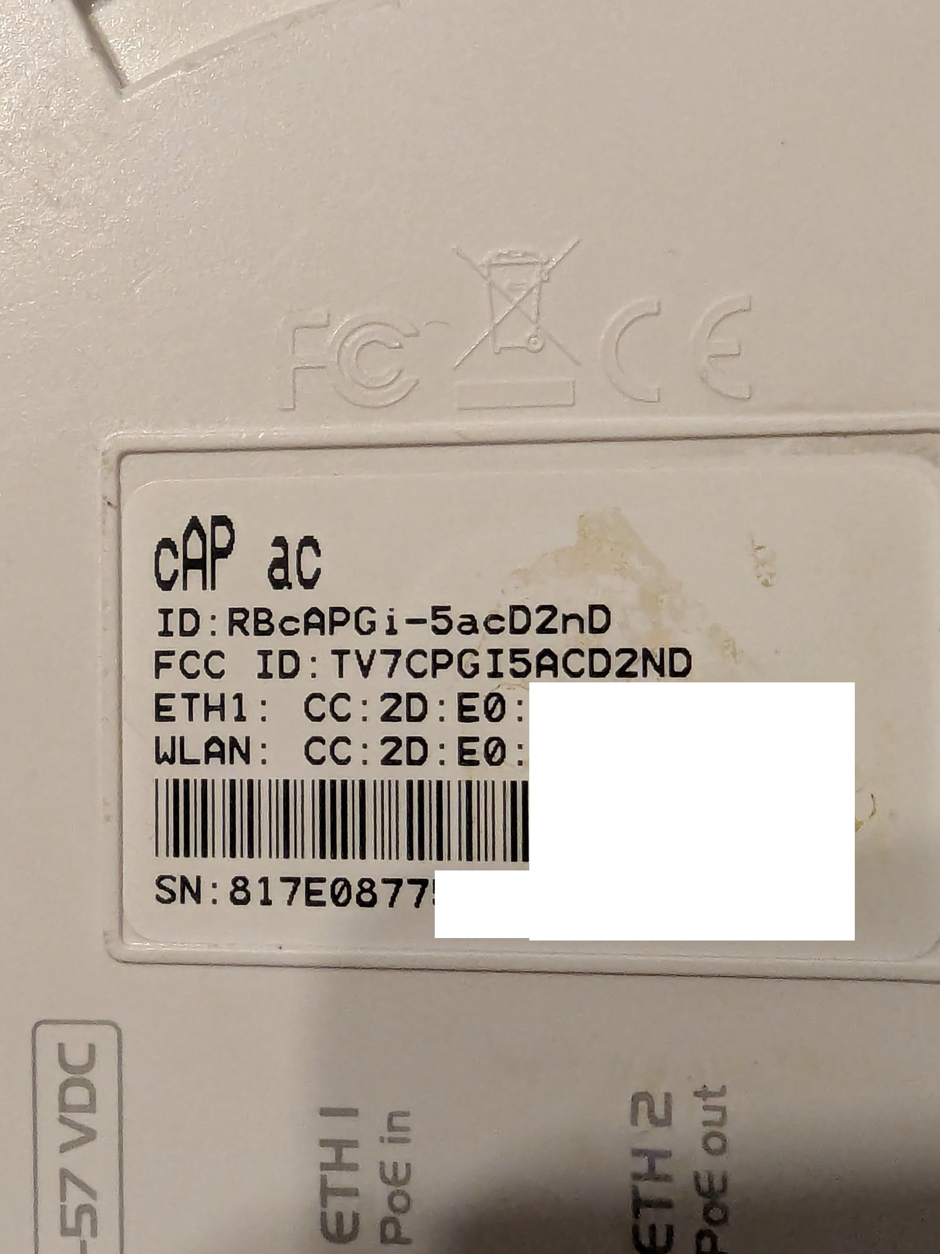

Do the MAC addresses correspond to those on the labels?
CC:2D:E0 Is august 2017
D4:01:C3 Is december 2023
Of course they may have been spoofed, still they could be used to distinguish the older cap AC from the newer cap XL AC.

  1. As you can see from photos. MACs corresponds to labels.

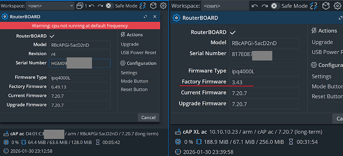

In your screenshot you somehow inverted the devices, the one on the left is the cap ac XL (by its serial HGM09 ...) and has factory firmware 6.49.13, the one on the right is the cap ac (by its serial 817E....) and has factory firmware 3.43.
They seem just right, 6.49.13 was released April 2024:

and 3.43 should be (please remember that firmware numbering "aligned" to ROS release is a recent change, in earlier times they had different numbering) around September/October 2017:
v6.41rc [release candidate] is released! New bridge implementation! - #250 by bajodel

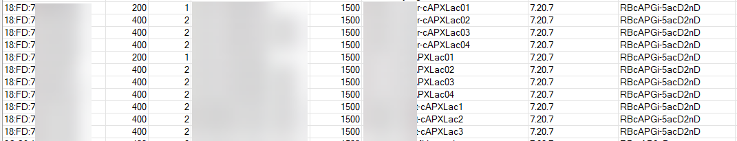

From holvoetn screenshot I see that his XLs all have the same RBcAPGi-5acD2nD naming as my ones. So this is “normal” situation for this model.
I still think its pretty bad idea by MikroTik to have same names for different models even if the only difference is another case and additional antennas on pigtails.
jaclaz, yes, you are right, I changed System-Identity to know which router is where, they both where laying on my desk for configuration… and I make a mistake ))) One more argument why this is bad idea. :slightly_smiling_face:
