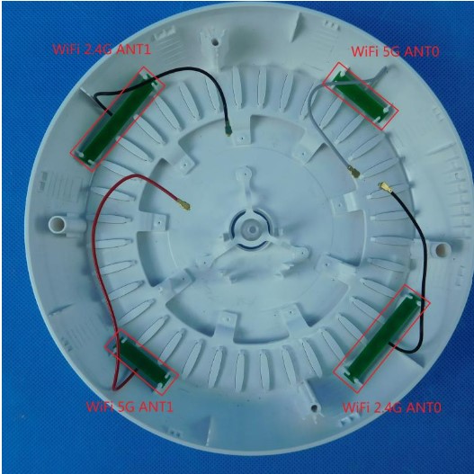

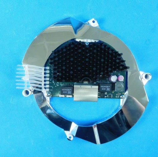

In cAP XL ac there clearly is a reflector. MT is not documenting the RF map of the cAP XL ac, we can only reverse engineer and guess, guess, guess …
To go from 2dBi to 6 dBi that is somewhat more than doubling. Or is it 2.5dBi to 5.5dBi, then it is just doubling (+3dBi).
Is the reflector causing the doubling or are the antenna doing it. (From a 2.5 dBi di-pole to a 5.5dBi antenna? and reflector as extra?)
From: https://fccid.io/TV7CPGI52XL

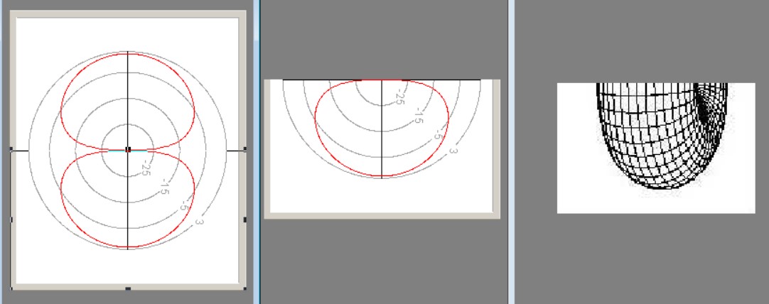

Are these di-pole antennas? Doubled the power in one half sphere by reflection? Then it should give something like a half-dipole-donut shaped spectrum
Something like this ??? Ceiling mounted orientation (https://en.wikipedia.org/wiki/Dipole_antenna)
It would be nice to have the real spectrum.
