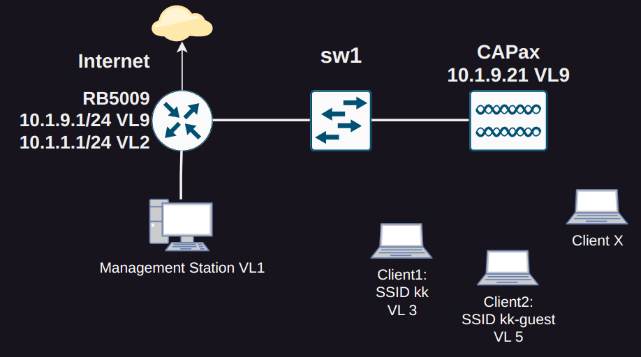

I am managing the network from the “Management Station” (my PC), from VLAN1. My RB5009 connects to the internet and routes between VLANS (nothing changed here, it was working well).
On the CAPax there are the following VLANs.
VL9 for management with the management interface 10.1.9.21
VL3 for privileged access 10.1.3.x, SSID “kk”
VL6 for guest access 10.1.6.x, SSID “kk-guest”
VL5 also for guest access, currently unused

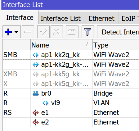

The Interfaces:

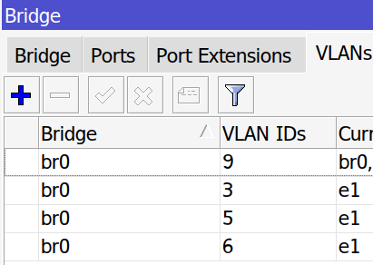

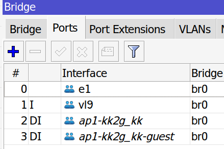

Bridge Ports:
Bridge VLANS:

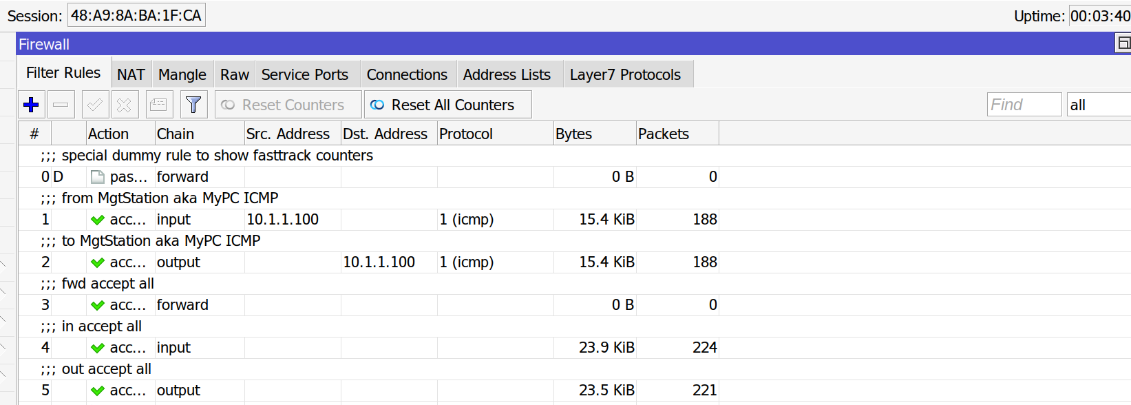

Also now I have just inserted 5 new rules before everything else. Everything is accepted in every chain:
add action=accept chain=input comment="from MgtStation aka MyPC ICMP" log=yes log-prefix=":from MgtStation aka MyPC ICMP" protocol=icmp src-address=10.1.1.100
add action=accept chain=output comment="to MgtStation aka MyPC ICMP" dst-address=10.1.1.100 log=yes log-prefix=":to MgtStation aka MyPC ICMP" protocol=icmp
add action=accept chain=forward comment="fwd accept all"
add action=accept chain=input comment="in accept all"
add action=accept chain=output comment="out accept all"
I can now check the counters increasing for my PC (10.1.1.100).
As my family just left home I was free to reboot as I like, so I just did it! :slight_smile:
Now I got the same misterious behavior, but I see more:
It seems like the packets are leaving the firewall as both rule 1 and rule 2 counters increase simultaneously.
This is true for both cases, it doesnt matter if 5G Interfaces are enabled or disabled.
I also launched tcpdump on my PC, to see what the ICMP packets look like.
With tcpdump I can verify if 5G Interfaces disabled I get replies, with 5G enabled I don´t.

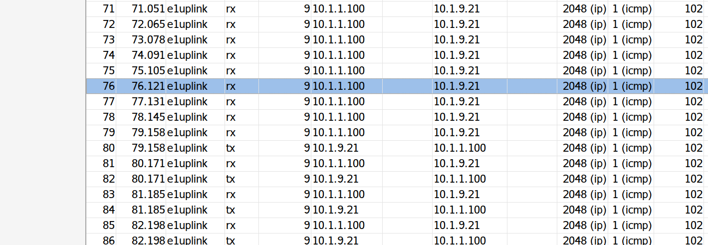

Here comes some more fun:
The uplink trunk interface on the CAPax does not see the ICMP replies until around rule No. 79, where I disable the 5G interface!
With no 5GHz Wifi, pings are answered.
/tool sniffer
set file-limit=10000KiB file-name=capax filter-interface=e1uplink \
    filter-ip-protocol=icmp memory-limit=1000KiB
If I put the trace on br0 I have same behavior.
I have downloaded the PCAP from br0, and opened it with Wireshark, but of course there is nothing special in there.
