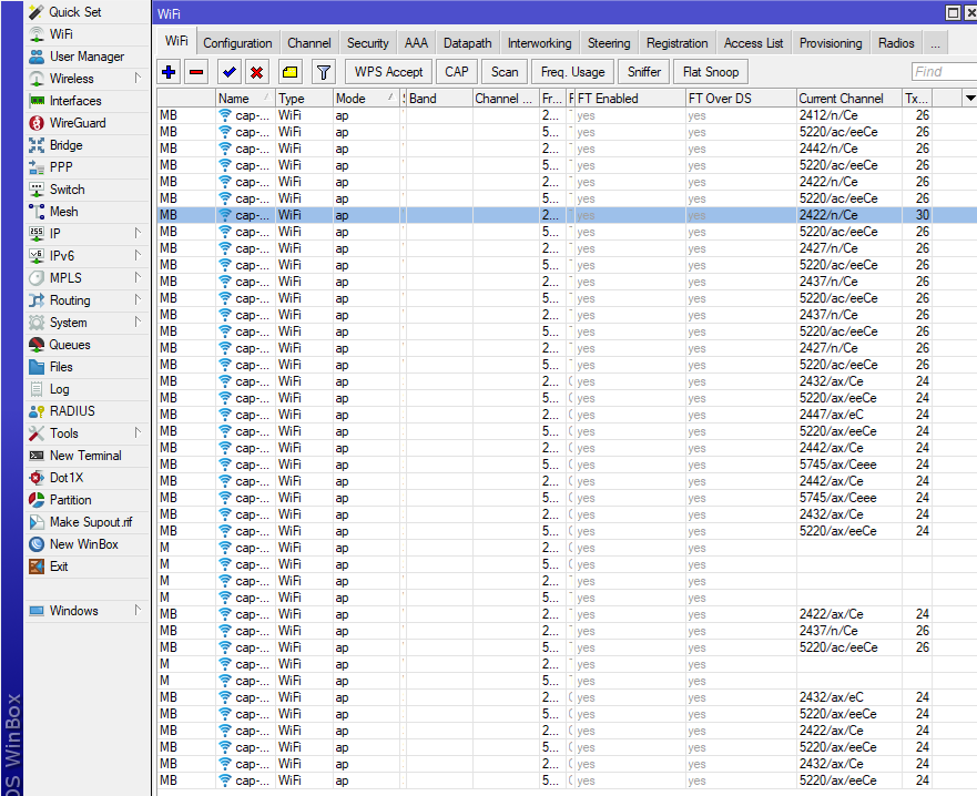

I have capsman2 with a dozen of mixed devices - cAPac and cAPax, over 50. The wireless clients are mainly connected to the cAPac model. After one wall only connected to the cAPac! For this, only one type should be used in certain places!

Can you please show how you did configure the cAP AX, @JohnTRIVOLTA?
This is not config.
Purely on that screenshot alone I see 15 radios using the same 5220 frequency …
You’re really killing that channel there.
Most ac, so I assume those are the cap ACs.
Then a couple of AX also using that 5220 (again: OVERLAP !!) and 1 with 5745, which is a UNII-3 frequency. I hope all your devices are able to use that frequency. Most will not be too happy with it, I am going to guess.
Ever heard of frequency planning ?
You should avoid overlaps, where possible.
You should also avoid using frequencies which can not be used by some of your clients (or accept they can not connect then).

In addition to holvoetn great respons:
Specifically on the 2.4GHz radio, you want to use frequencies 2412, 2437 and 2462 and a channelwidth of 20MHz.
This will prefent interference as much as possible, but still be present.

For all who comment, except the last last one: Аll the caps are on auto frequency selection and are located at a sufficient distance from each other, and those who are nearby in the same hall should choose one that does not overlap! In capsman2 no roaming room, but have FT - enabled for ALL.
