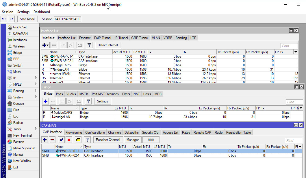

Hi Preytell
I tried CAPsMAN with 2 PWR-Line and a hEX as controller. It works fine. You can use the default config of the PWR-Line and just enable capsman on bridge interface of the PWR-Line.
I tried moving the PWR-Line in different rooms (same phase) and it connects fine to the CAPsMAN.
Config CAPsMAN on hEX down under

This is layer 2 communication. I haven’t tried with IP but it should work.
