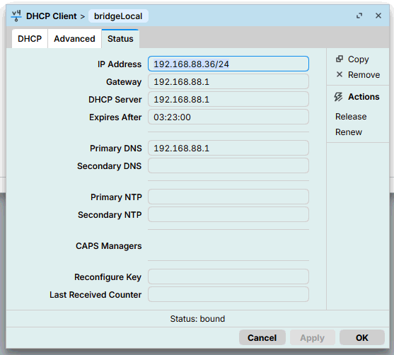

What's type of access points and I guess somebody is currently typing "Upload router config"... I assume you're able to access the APs via WinBox? If so, I'd check IP/DHCP client/Status and check the access point has valid IP details esp. DNS:

Guess what? It was the DNS :sweat_smile:
