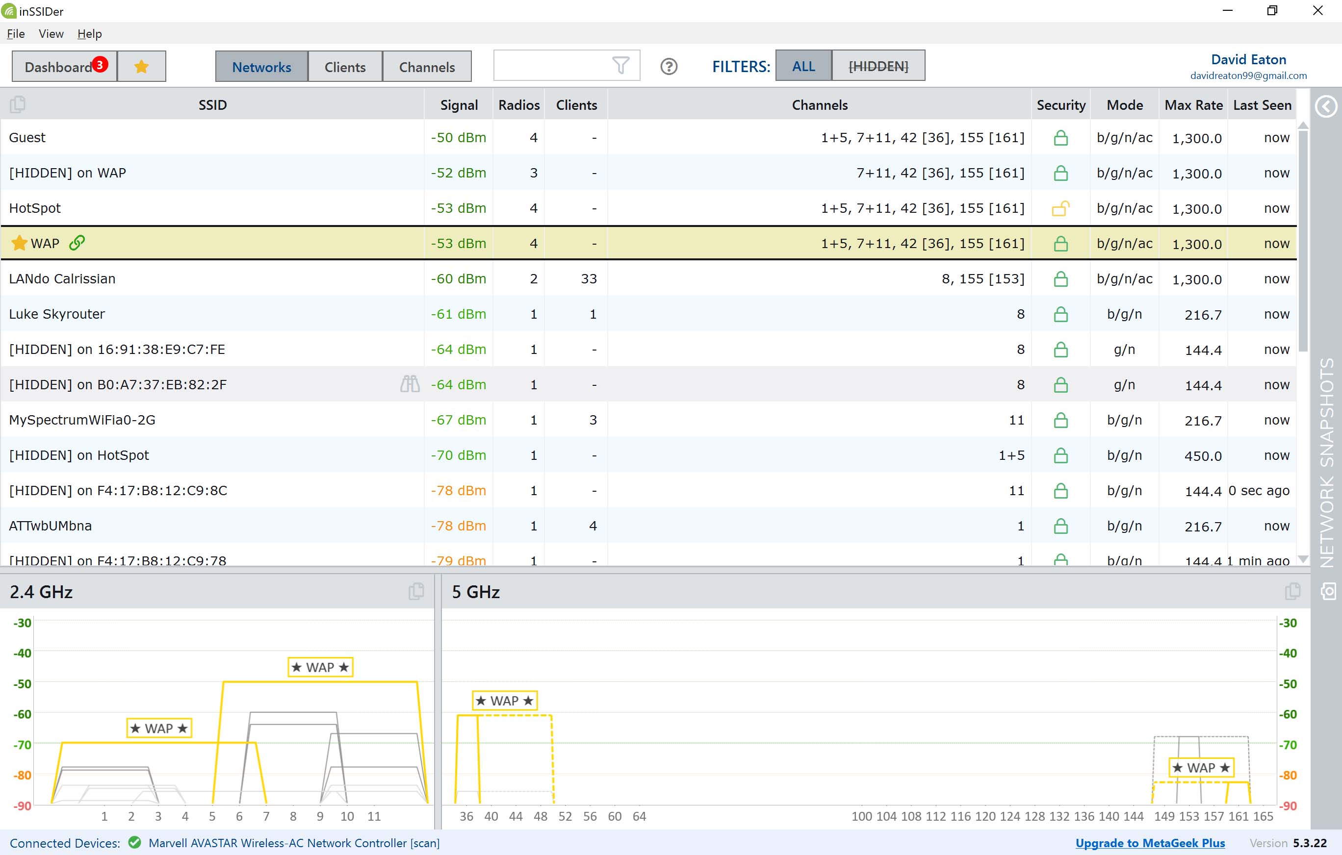

I’ve used capsman for a couple of years, provisioning 2 dual band APs. I’ve had problems moving between 2 access points, loosing connections etc. I fired up InSSIDer and found that my 2.4 GHZ bands are very wide and overlap (attached). Sometimes they’re on top of each other. My configs (attached) call for 20 MHz band width with no extension channels for either the 2.4 or 5 GHz bands. I think my capsman configs and provisioning are very simple and basic. What am I doing wrong?
Help appreciated!

Make sure extension-channel=disabled. By default they are enabled.
Thanks, @biomesh. That helped a lot! I don’t recall seeing that as a default.
