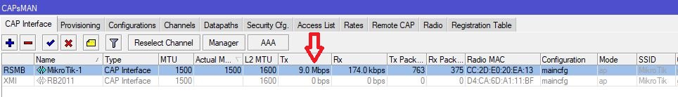

i prefer capsman forward because i can observe at capsman what upload/download speed every cap is having!

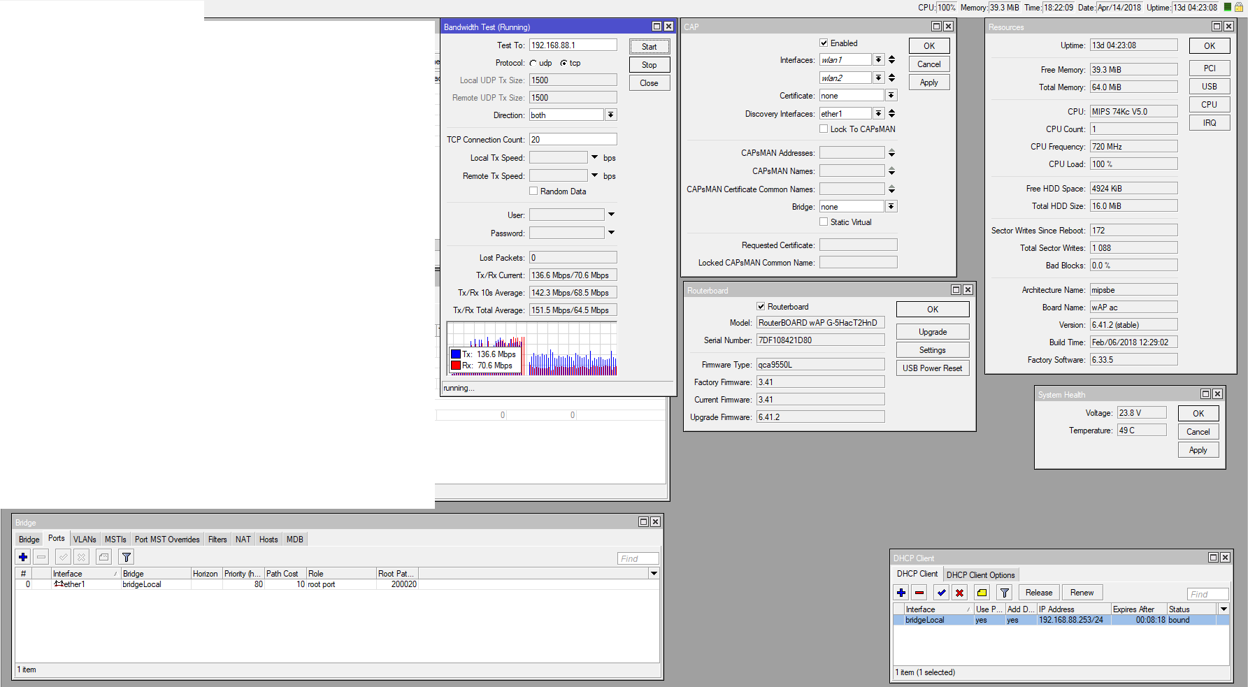

yes you are right. i made a btest with a ccr1009 and a rbwap ac and i can hit 100% cpu usage.
take a look btest tcp,both direction,capsman forwarding of a rbwap ac.
