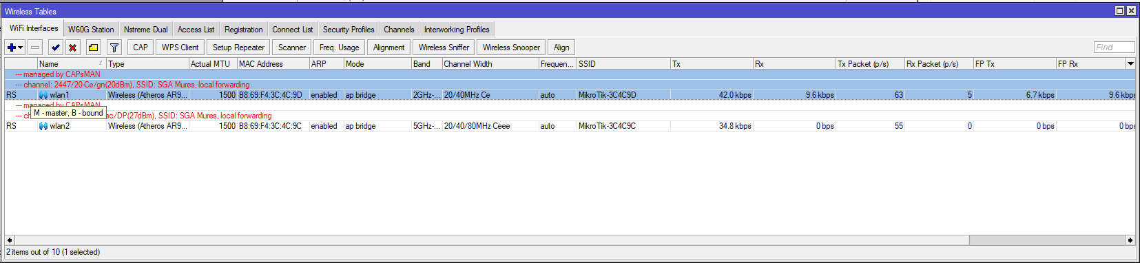

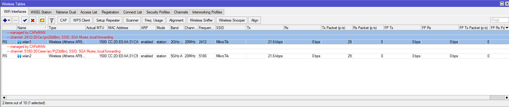

These are the settings from the CAPs.
The print screens are from the CAPs winbox settings. I could try to reset it, but I am asking for an opinion of why the two are different and the setting cannot be managed.
My opinion is that you misconfigured one accesspoint. Untill proven otherwise…

Guys, if you see the red 'managed by capsman" on the interface, it means all settings are in the capsman side. NOTHING in this device is used, all this “station” mode, does not matter. Actual config you can see on the CAPsMAN side, not on thre managed unit. All is ok in your setup and it should be working.
Thanks, glad they are both reporting the same mode. You could consider resetting CAPs2 as well, there seems to be some legacy settings present.
Ok. Thanx.
I managed to have two instances of CAPsMAN on the same device. Is there a way to have a single instance that manages both AC and newer AX CAPs?
I will reset them all again, It is quite easy. Thank you!
Only ax and ac ARM devices can be handled by the same instance of CAPsMAN, any mipsbe device requires the old(er) CAPsMAN.
Sooo many “but”s. It works, but. It works only with…
Thank you for the clarification
