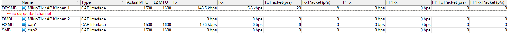

I have a RB4011igs with two RBcAPGi-5acD2nD. I am trying to create a CAPsMAN wireless to have the same network over the apartment. On the first CAP device I am having both 2 ghz and 5 ghz network. However, on the second CAP device I am having only 2ghz network. The 5 ghz channel has the error – no supported channel. What am I missing? There are a lot of other wireless networks around me, could it be from them or I have misconfigured something?

It seems the export doesn’t contain the second CAP device. You can find the screenshot as an attached file.
Change installation=indoors to installation=any. This setting affects frequency availability and Mikrotik uses this in a very unusual way. And with more than single cAP device, you realy shouldn’t be setting mac-address or radio-mac or radio-name in common configuration. Either leave it unset and let CAPsMAN provision it automagically or create provisioning rules which will explicitly set different values to each of cAP devices.

When they are not in CAP it is OK, both have 2ghz and 5ghz networks. But I want to set them in CAPsMAN for convenience.

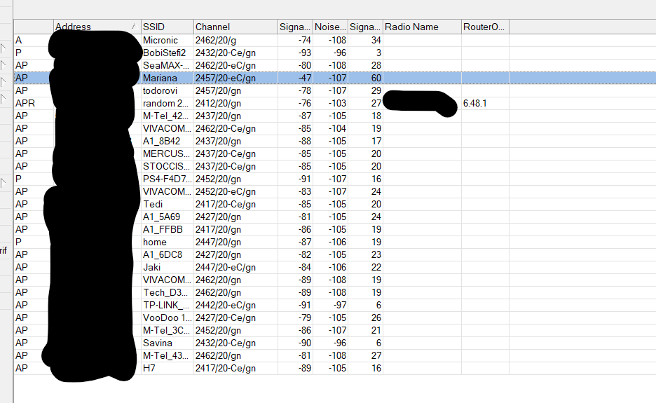

You don’t have to switch to DFS channels…it depends on the use of the band (use the CAPsMAN > Registration Table > CAPs Scanner to find least used channel).
Indeed missed the country settings.
Can I scan with the terminal in /caps-man or it is only available in the AP’s /interface wireless? I can’t find it in google.
Also, it seems for 2.4GHz 2462 is least used. Are frequencies ordered by priority, or the AP decided by scan which to use? I currently have:

Everything is good, except occasionally, one of the CAP devices looses the network. It stays inactive for a while and then it recovers. I have a really strong signal from the apartment above me. Could this be the issue? Its SSID is Mariana. My second CAP is with SSID random.
I tried turning out 2.4 ghz on the router with issues and it is OK now. But can I fix it?
I forced the cap with issues on channel 1. It seems OK for now. I also had a nearby channel 48, so I removed it from the list of channels for 5ghz, now I am only on channels 36,40 and 44. It does seem OK for now. For some reason (not sure if it is this), it seems the throughput of the wireless got better. I was getting 60-80 mbps, now I can do above 100 mbps.
