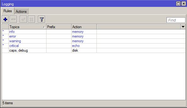

I think that looks good. Are you able to add the debug-cap rule on that cap which isnt working? We most likely need the part when it stops working so you could maybe log to a file and upload it after you see that its not working anymore?
debug-log rule would be topics=caps,debug
I did it. No success. My CAP have lost 5GHz again.
but nothing in log. I attached screenshots. Log file with caps, debug is zero bytes length.
