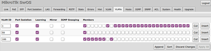

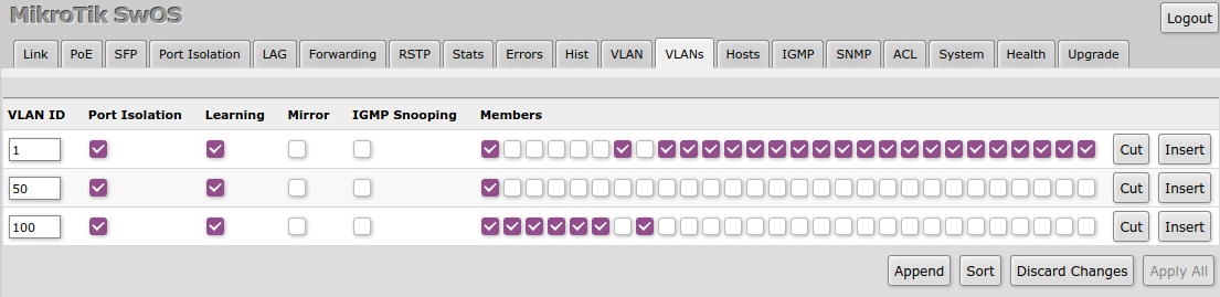

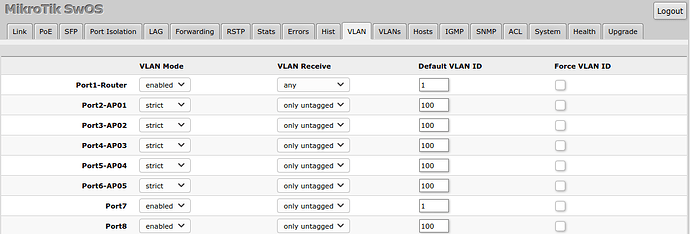

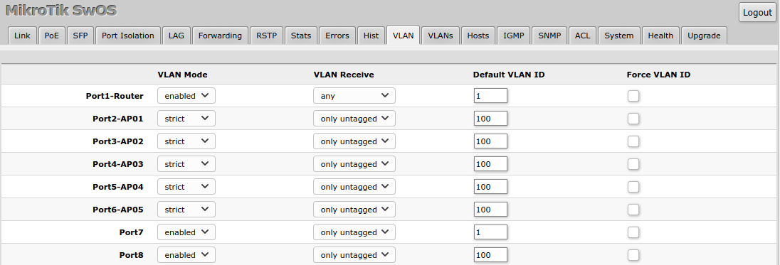

/interface wireless cap
set bridge=bridge caps-man-addresses=172.30.30.30 enabled=yes interfaces=wlan1,wlan2
Switch settings in attachments
