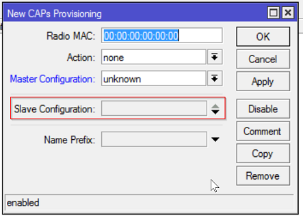

Anyway to get a virtual AP up and running under CAPsMAN (under a different profile/config), or even just add a Virtual AP to a router that the primary AP is controlled by CAPsMAN?
/caps-man provisioning add slave-configurations=
See this page a made
In dutch but folow the printscreens a made
http://www.wirelessinfo.be/index.php/mikrotik/pages/cap2
Thanks, Was looking in the wrong place for this, worked like a charm, though I think I found a few bugs in the AP provisioning process (will email support later this week)…
