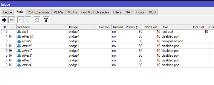

this is what it looks like after restarting the router or all interfaces in “Cap Interface”:
after a few hours it looks like this
Everything still works wherever the clients were connected. However, where there were no customers, each newly connected is not in “bridge”
We are aware of an issue where the CAP interface wasn’t added to the bridge, the fix is available in versions after 6.49beta16. So you shouldn’t notice this problem in the beta branch. But you can write us a support ticket and we can double-check if it’s the same issue.
