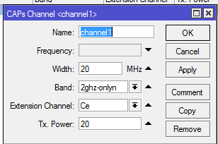

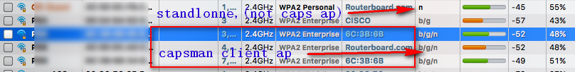

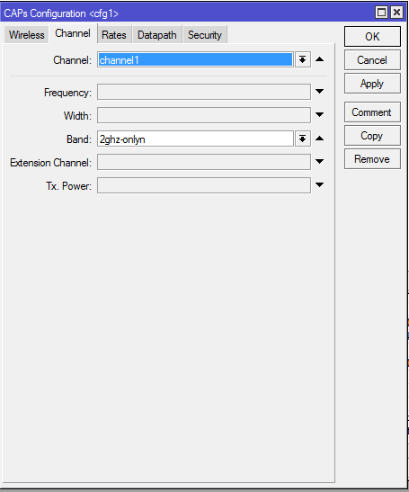

have set band lock to 2g-n only. but not work. tried set band lock in capsman/channels and config. both failed.
is this a bug?
Maybe what you see in the WiFi analyzer software, is what the station is CAPABLE to do (in your case b/g/n). It is not showing that the station is PROVIDING the b/g/n service.

Select a channel/frequency, after that choose a band: 2ghz-g/n or 2ghz-onlyn.
thanks, but I would prefer auto frequency.
stick to a fix frequency may not be a good idea for me. there are toooo many 2.4G APS nearby. (more than 50 AP, and 50+ IOT wifi). channel sucks.
