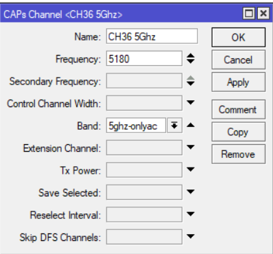

  1. Set the Control Channel Width to 20MHz
  2. Set Extension Channel to Ceee (for 80MHz) or lower for 40MHz or 20MHz
With these settings you will be able to use ac.
Here is a good read: https://wiki.mikrotik.com/wiki/Manual:CAPsMAN#Channel_Groups
For 5 Ghz, just do not set anything besides frequency and band on channel settings
Example
Have a look here:
http://forum.mikrotik.com/t/5ghz-on-cap-ac-not-visible/136262/1
