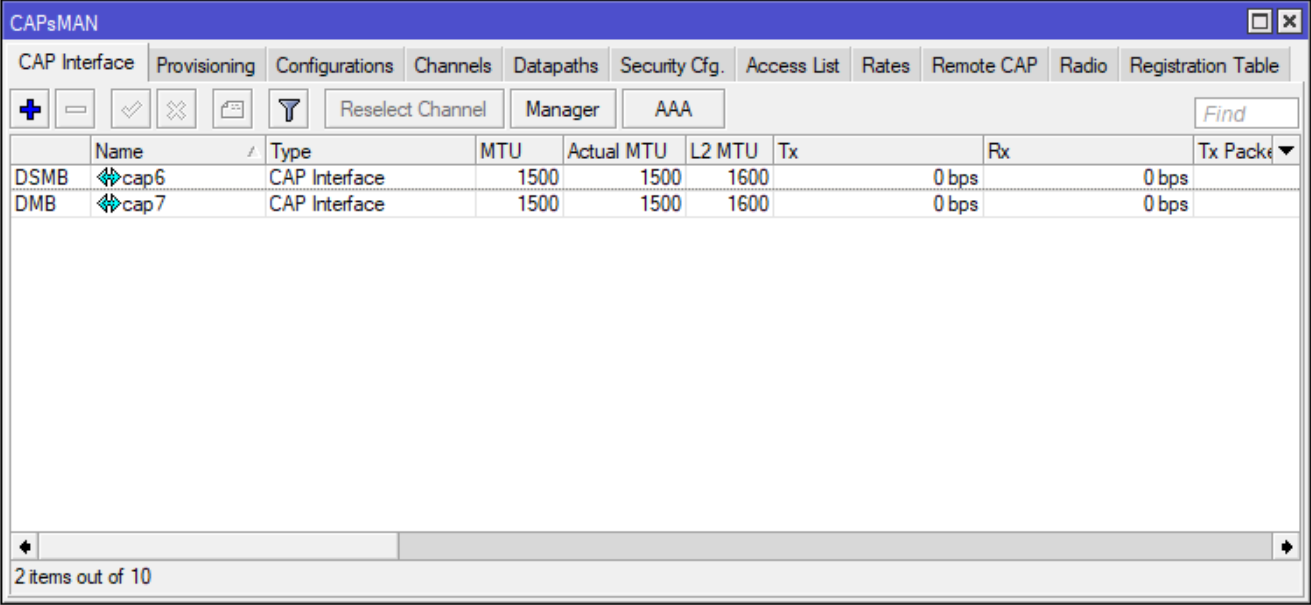

But shouldn't CAPsMAN create interfaces dynamically when I'm provisioning the radio with action=create-dynamic-enabled? I see interfaces in the CAP Interfaces view in Winbox:
Check the status tab of the 5Ghz interface. Is it in state running-ap? What channel?

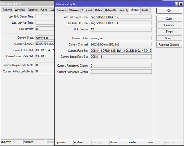

Both are in status running-ap. The 2.4GHz interface has last link up & down times, the 5GHz interface doesn’t:

Your 5GHz is running on 5785 MHz (157 Channel) - not all devices and not in all countries support channels 149,153,157,161.
Try changing to 5150 – 5250 MHz
