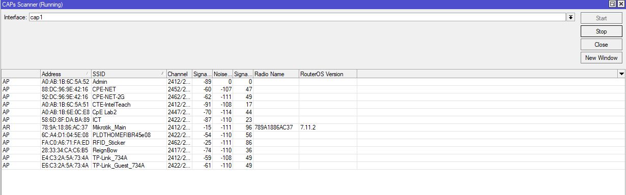

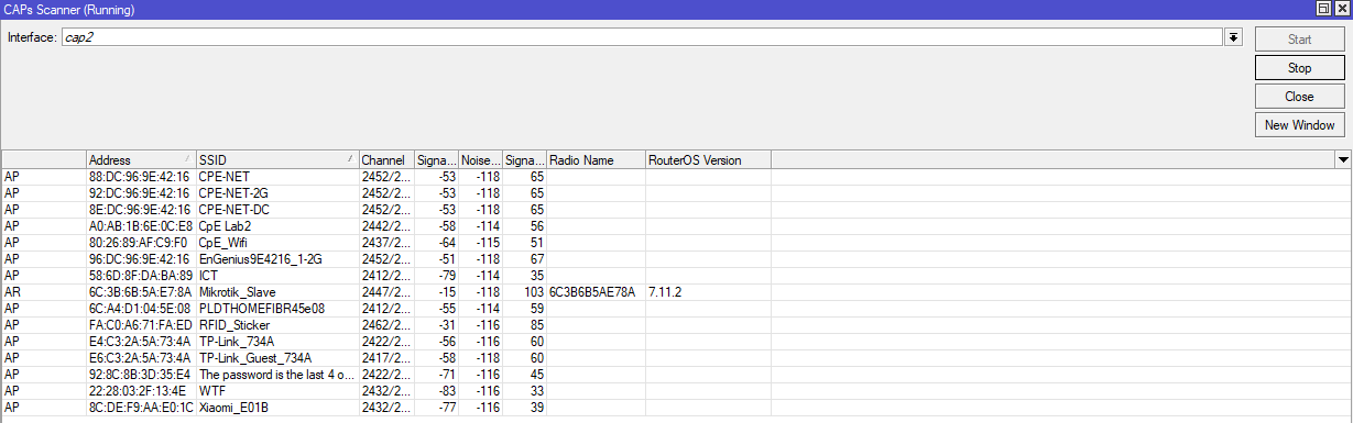

In CAPsMAN, I am trying to get the CAPs Scanner data using API in python. I want to acquire the data from the CAPS scanned data AP from cap1 and cap2. Is this possible?
Is it possible to use API to remotely scan in CAPsMAN?
Request:
/caps-man/interface/scan
=interface=cap1
=duration=2s
.tag=1
Response:
!re
.tag=1
=address=44:05:3F:xx:yy:zz
=ssid=MySSID
=channel=2412/20/gn
=sig=-88
=nf=-110
=snr=22
=radio-name=
=.section=1
