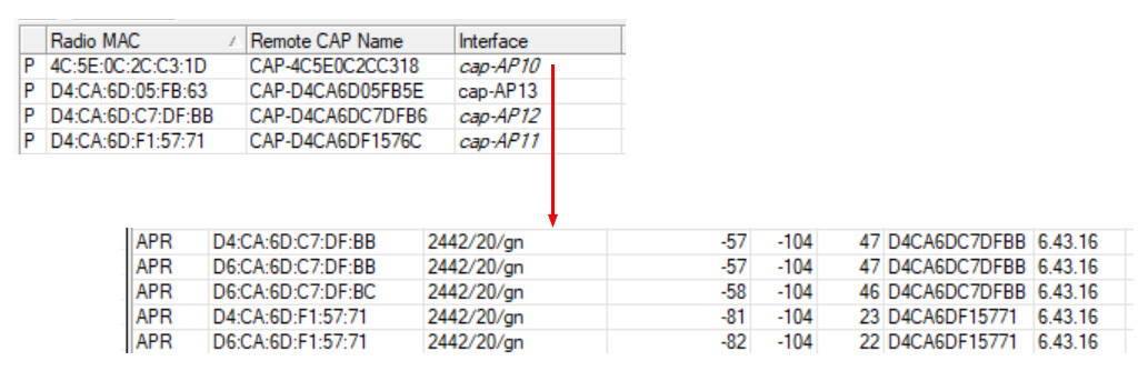

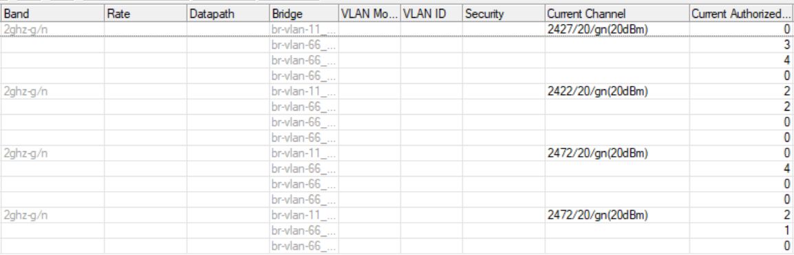

Not so far. Screen from scanning one of CAPs. Now, all are on the same channel.

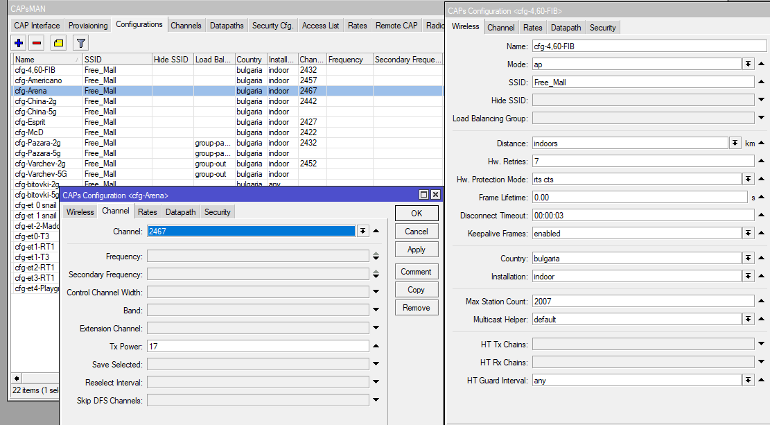

  1. Scan the room with WiFi analuzer with your phone to see the free frequencies
  2. Set manualy Tx Powet 16 ot 17dBm (iphone transmit with 12-13 dBm)
  3. Set manualy channel, may be close but different
  4. set point by point. Run the first and go see if it works. if it is not good - change the channel. Then the second …

Tx Power to 10 or less is too low for me. This will affect the scope range 12-13m. I think between 15-16dBm is good.
I also had problems with a capsman, nearly two years. By noon he works and then stops. These settings saved me.
