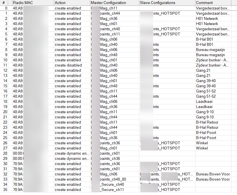

The screenshot I showed you has 36 provisioning rules (17 APs, each having 2 radios and then 2 blank MAC rules for if I have to add a new AP, to make sure it has something).
I have 7 master configs for one SSID, 10 for another one. Should I have to change configs for 1 SSID, that's maybe 5 minutes work. Not more.
