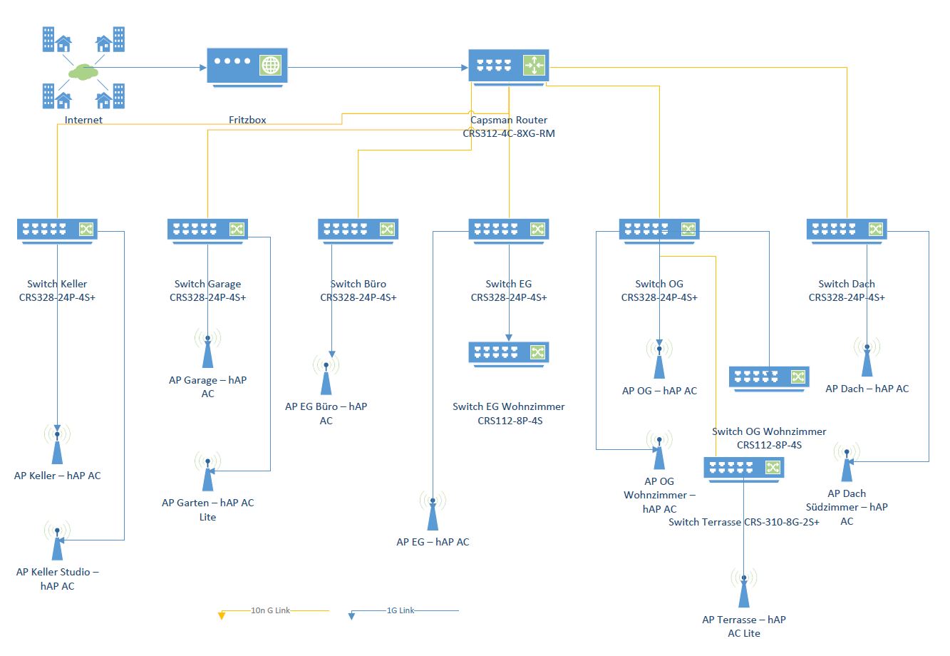

I got my home setup up to 11 APs controlled via Capsman:
