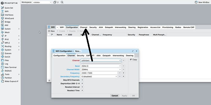

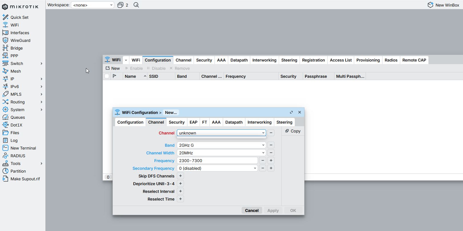

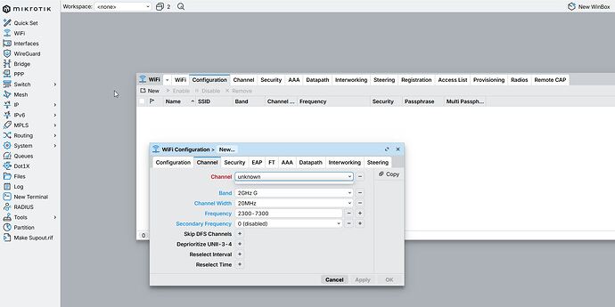

One thing that tried to check on configuration:
In WIFI configuration Channel select is only unknown, not possible to select channels.
Can select BAND, Channel Width, Frequency.
I already using wifi network from CAPSMAN quick set.
Do I need delete this setting and start from scratch ?

Repeat request.
Your config is wrong
If you don't define them first, they don't exist.
Other people have written to you, and you're ignoring them.
That doesn't seem polite to me.

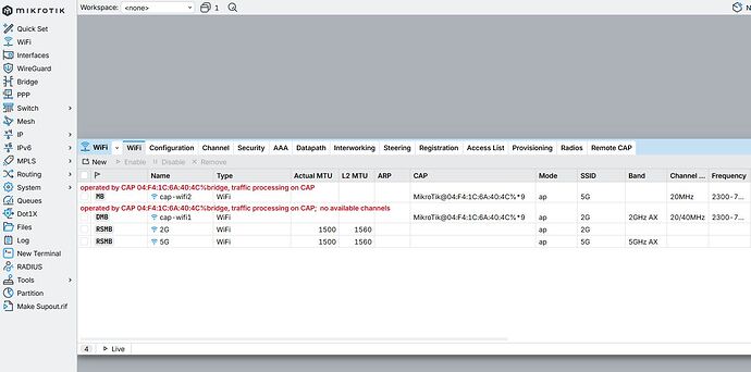

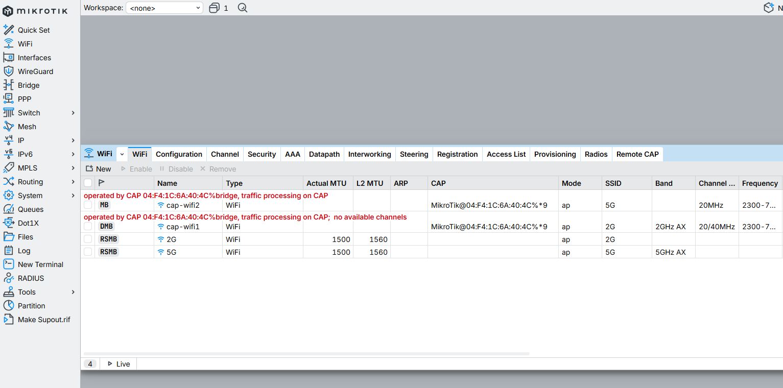

Looks like I get it working right now.
Problem was that I did not create channels before as mentioned by.
rextended

One config is CAPMAN. other CAP
At least the provision rules are missing on the CAPsMAN. Did you provision the CAP manually? Also it seems there is no configuration, which is necessary.
On your CAP there seems to be a lot of unnecessary settings, while all you need is something like:
/interface wifi
set [ find default-name=wifi1 ] configuration.manager=capsman .mode=ap datapath=capdp disabled=no
set [ find default-name=wifi2 ] configuration.manager=capsman .mode=ap datapath=capdp disabled=no
