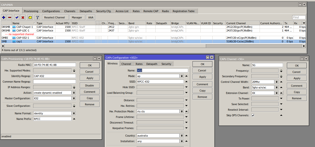

I am adding a RBcAPGi-5acD2nD dual band cAP to an existing set of RBcAP2n 2GHz-only devices managed by CAPsMAN on a RB750 router. At present, I only have a single 2GHz SSID, “RPCC-Staff” on all cAP2n devices. I want to create a 5GHz service on a separate SSID “RPCC-X32” utilizing the 5GHz radio on the new device, using the same CAPsMAN instance. If I specify a 5GHz channel, the service created is:
i. A cap named CAP-X32-1 with SSID=“RPCC-X32” with the error “–no supported channel” (Current State = no-channel);
ii. A cap named “cap1” with no SSID on channel 5200/20-eCee/ac(17dBm).
If I remove the 5GHz channel , then CAPsMAN creates a valid RPCC-X32 SSID on the 2gHz radio. Not what I want.

Thanks akmodi, definitely progress. I now have a 5GHz service with a SSID. Current State = running-ap. However , there’s a cap that is still trying (unsuccessfully) to bring up a 2GHz service. Is this an artifact that I just have to live with?
You don’t have a supported channel on the master radio.

Why this ?
add band=5ghz-a/n/ac control-channel-width=20mhz extension-channel=XX name=5G
skip-dfs-channels=yes
Try to use as much as possible default values, add one by one.
You can also delete that provisioned 5Ghz-line trying to be 2Ghz :laughing:
It should be reprovisioned, if needed.
Why this ?
That was just an un-removed parameter that I had previously tried. It hadn’t occurred to me that a dynamically created service could just be deleted.
Thankyou.
