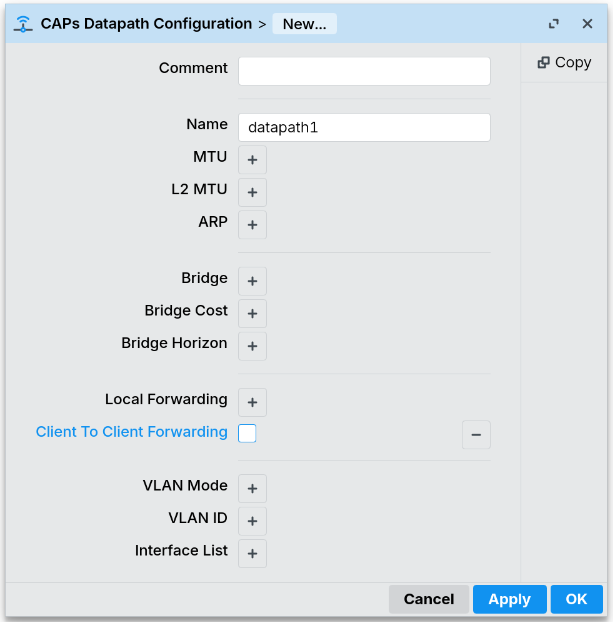

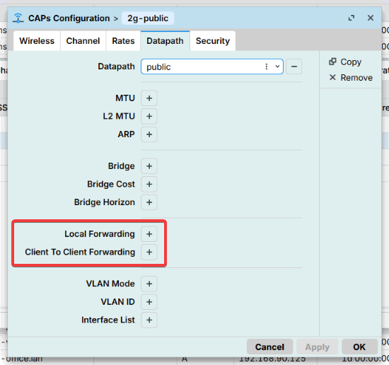

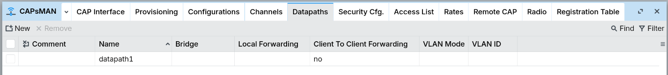

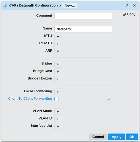

On wireless CAPsMan it should look like this.
