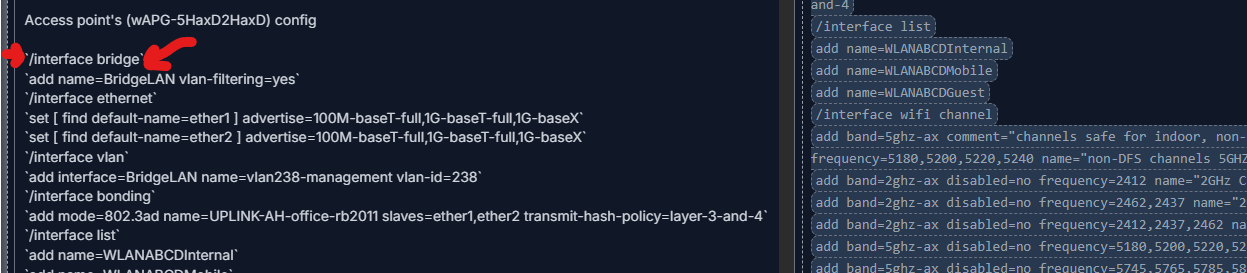

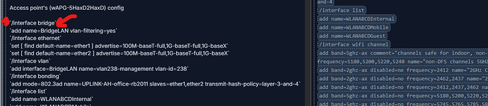

Configurations of AP, RB2011 (acting as a switch here) and main router follow:
Access point's (wAPG-5HaxD2HaxD) config

Hi

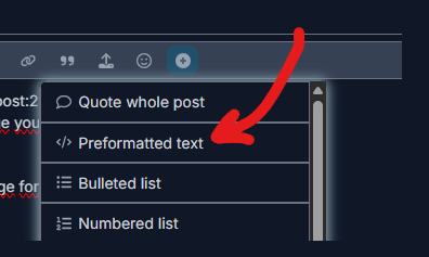

please change formatting for code in the post. It would make reading easier.
Use code tag < / > from the menu or just put three backticks (usually the key left to the "1" on the US keyboard) to mark the beginning and next three ones the end of block of code. You can append RouterOS after the first backiticks to help the forum engine format the text.
No, you did not. Each line is enclosed with singla backticks.
You were right, sorry for that.
