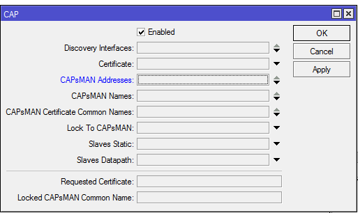

Where is CAPSMAN config on wifi-qcom-ac? In client, there is cap but without interface
CAPsMAN is configured through the WiFi menu on the Remote CAP tab, CAPsMAN button (or /interface/wifi/capsman). It is available since 7.13.x and has nothing to do with the additional package/driver.
