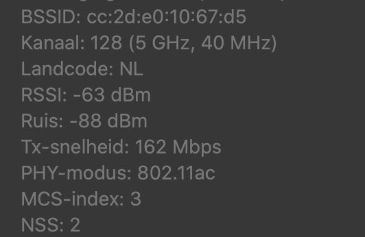

Macbook works (same with phones)
Windows mentions: “could not connect to this network”. If I kill the 5Ghz network and windows needs to change to 2.4Ghz, or force with network-wifi-adapter to “n” standard, they do work.
