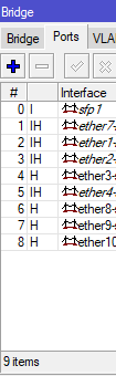

Remove wlan interface on the device from any birdges you want to use as cap.
It first that i did
I even setup other router that managing by main and it’s work perfectly. But wifi on main router still does not work.
On main router you also exclude wlan from local bridge,and configure as it was remote AP.
