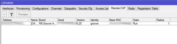

Capsman says the groove its running.
But i can’t enable the radio

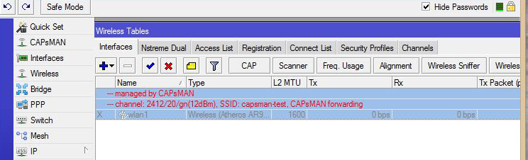

The screenshot from the Groove is normal.
It states “disabled” because the interface is remotely managed by the CAPsMAN. Thus it’s not available on the system you’re logged on to.
Everything is fine, you see that it’s running in CAPsMAN.

Hello cdiedrich, but i see no SSID this is weirde
Weird indeed.
I just re-read your config - you selected TX chain=1. AFAIR the Groove only has one which is 0 by default.
Try switching to TX-chain=0
-Chris
